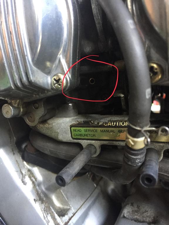

  9. On my 84 Venture I noticed a tube sticking out with nothing on it.(carb #2 ) There is a small diameter hose hooked to where you synchronize the carbs. Can’t really see where this small hose goes to yet until I start pulling more stuff off. Should this small hose go onto the tube and the tube for the sync gauges be plugged off?
