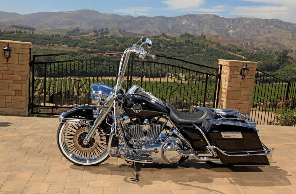

I've been toying around with the idea of making my 05 RSTD a lowrider style bagger, or softail style. Our bikes are the direct competition to the Harley Road king, so why should they have all the fun. I have a set of 16 inch narrow apes from khrome werk and I'm looking on Ebay for fishtail slip on exhaust. The only part I'm kicking around is keeping the bags on or riding bagless.[ATTACH=CONFIG] 112950[/ATTACH]
