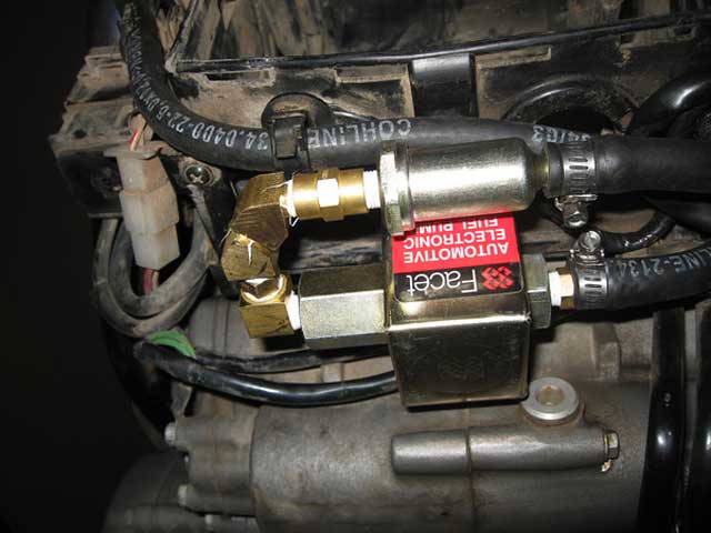

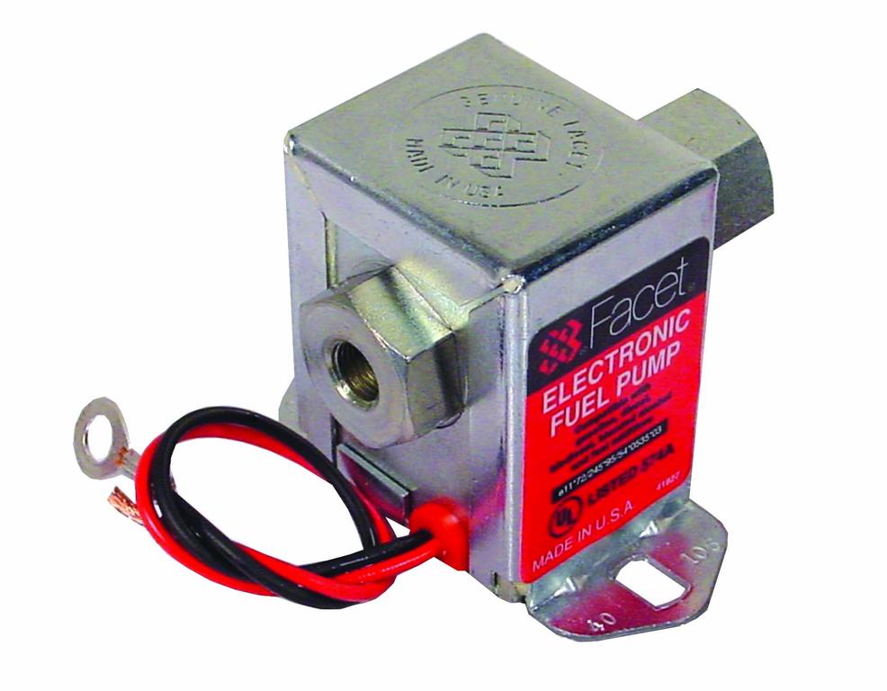

Have anybody successfully installed one of this fuel pumps to their 1st gen ventures? It is solid state and built in check valve Specs: VOLTAGE: 12 PART & CROSS REFERENCE NUMBERS: FACET 40171N, TENNANT 19171 FEATURES: COMPATIBLE - WITH LEADED OR UNLEADED GASOLINE, DIESEL FUEL, BLENDED FUELS, PURE ALCOHOL & FUEL ADDITIVES. RELIABLE - NO ELECTRICAL CONTACTS, BEARINGS, RUBBER DIAPHRAGMS OR VALVES TO WEAR OUT OR FATIGUE. EASY TO INSTALL & SERVICE. ELIMINATES VAPOR LOCK - FOR CONSTANT, SMOOTH FUEL DELIVERY ON HOT DAYS & HIGH ALTITUDES. PRESSURE RELIEF - ELIMINATES FLOODING & ASSURES SATISFACTORY RESTARTING ON THE HOTTEST DAYS. CORROSION RESISTANT - THE ALL STEEL CASE IS PLATED TO PROVIDE OVER 100 HOURS OF SALT SPRAY RESISTANCE. SELF-PRIMING - TO 12 INCHES OF FUEL LIFT. FILTER SPECIFICATIONS: N/A FITTING TYPE: 1/8-27 INTERNALLY THREADED GPH: 15 MIN DRY LIFT: 12IN / 30.48CM MAX SHUTOFF PRESSURE: 3.5 PSI MIN SHUTOFF PRESSURE: 2 PSI NEGATIVE LEADS: 0.25" RING TERMINAL POSITIVE LEADS: PACKARD 0.25" 28HSG INCLUDES POSITIVE SHUTOFF VALVE?: YES INCLUDES CHECK VALVE?: NO INCLUDES QUIET VALVE?: NO PACKAGING: BOX APPLICATION: ALL CARBURETOR-EQUIPPED CARS, VANS & LIGHT TRUCKS, STATIONARY ENGINES, GEN-SETS, FUEL PRIMING & TRANSFER APPLICATIONS WEIGHT: 1.115 LBS / 0.51 KG FACET FUEL PUMPS 40171
