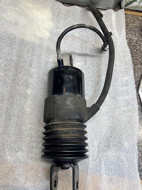

  1. Just swapped out the shock with a hagon, can anyone use this to rebuild. Only interested in cost to ship to you from Delaware. Came off a 2013 RSV, just started leaking, about a quarter size drop after last 2 rides
  2. Is there any specific order to remove the bolts and old shock? New Hagon should be here tomorrow and just checking before I start pulling things apart. I know I need to take the pressure off of the rear wheel. Thanks
  3. Thanks, oem replacement is over $900, have seen the Hagon for $500ish, I don't have a need for the air shock Appreciate the input
  4. Hi All, Out for a ride today and noticed a small puddle under my shock. Going to replace soon, just wondering, any tips, things to do not do, and options for a shock other than OEM. I have looked at the Hagon M62097 rear monoshock, any others? Thanks Bob
