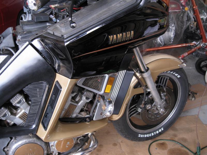

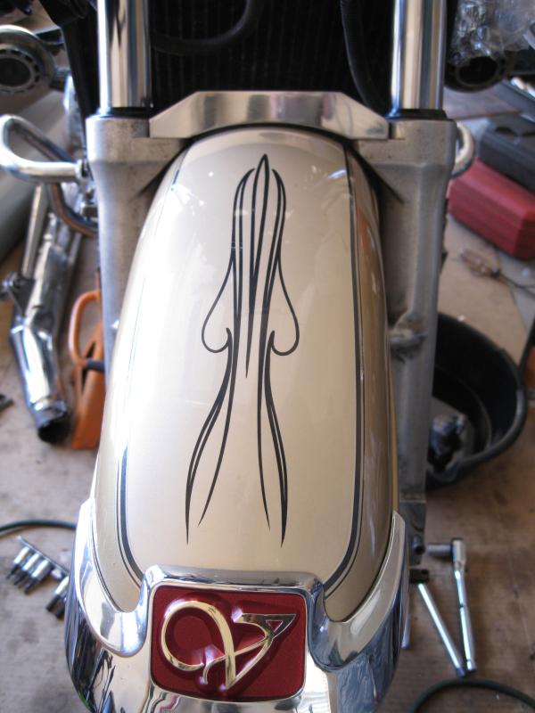

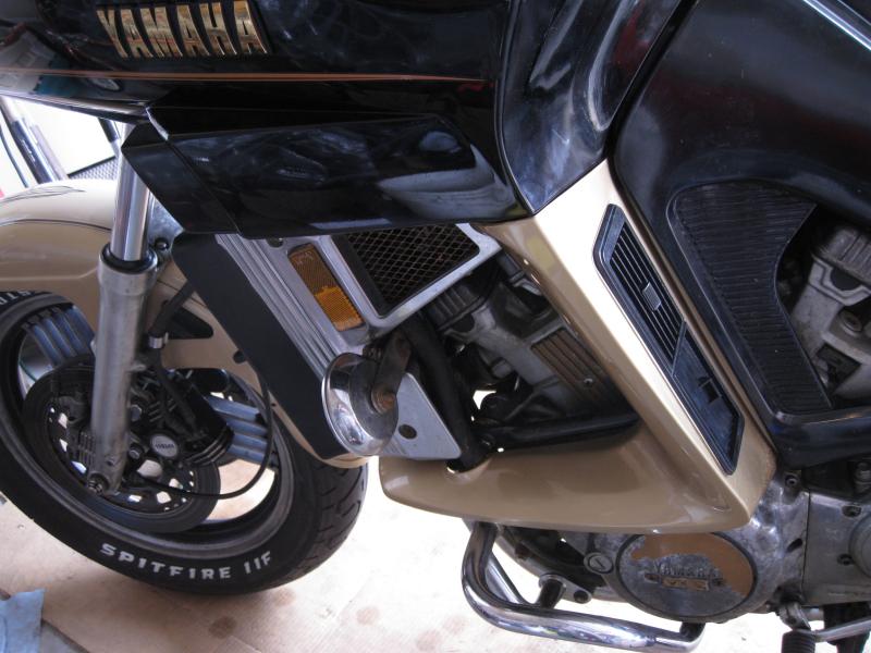

And today. Replaced all of the black plastic, it was all busted up and ugly. I like the black and gold combo, looks nice. Don't know if I'll ever replace the side bags, hard to find in decent condition and I've already sunk a ton of dough in this thing. But it keeps me off the streets and out of the nursing home, so the heck with the money. Most of my acquaintances throw their money into airplanes, fast cars or fast boats, so I can afford to do a bit more.
Hope y'all enjoy the pics, wish they're were more!

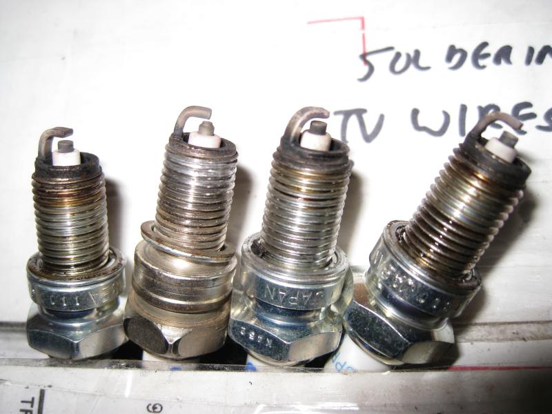

So with a little over 500 miles since I first got it running after 6 years in the rain, thought I'd post a picture of the plugs I just removed. I'm replacing the NGKs with the Denso iridium IX24Bs. Very happy with the coloring, especially with what it took to get it running correctly.
From left to right it's 1, 2, 3, and 4. You may notice #2 threads look funky. I guess the PO may have cross-threaded this one. It's also an Autolite; I left it in place since it didn't turn freely. I ordered a 12mm reverse plug chaser to try and clean it up. I don't want to get into an engine teardown until the move to New Mexico is done in the next couple of months.

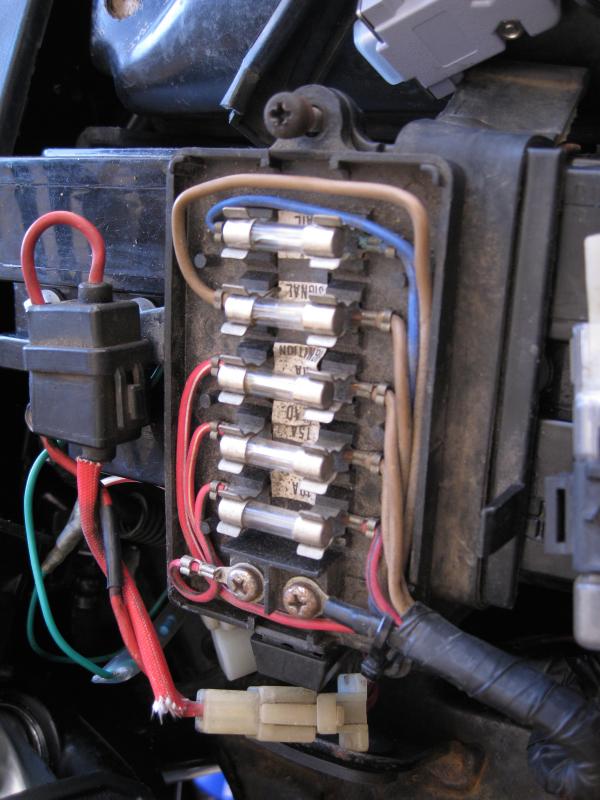

What kind of bike? 1st gen Venture with the glass fuse panel on top of the battery? There's an ignition fuse there. Does the starter spin, or is everything dead? There's a fusible link at the positive terminal of the battery that may have melted.

I no longer use NGK plugs. I had 6 out of 8 go bad in the worst way. They electrically OPENED internally in less than 2000 miles. Suppose to be 5k ohm resistance on each plug. Both resistor and non-resistor type did this=Infinite resistance. No, it's not my wires or caps as wires are new caps test good and caps were cleaned internally by me. All tested by me a 30+ years working on electronics. FYI- NGK caps go bad quickly too. Now using Denso iridium IX24B. No problems past 6k.
Interesting. I'll look into these myself.

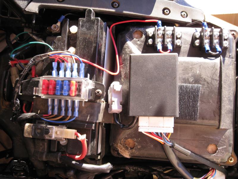

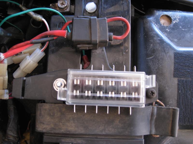

When I upgraded my battery cables Gary included the same fuse as in his photos. I like it, made for a clean installation, looks good. I had two of the old-style fuses, but only one had the spares. I found them the same way Jeff did.

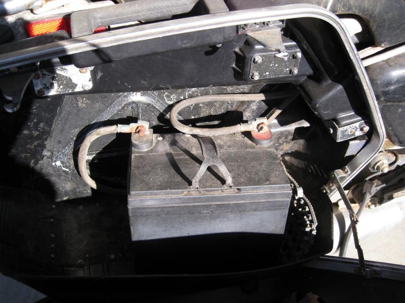

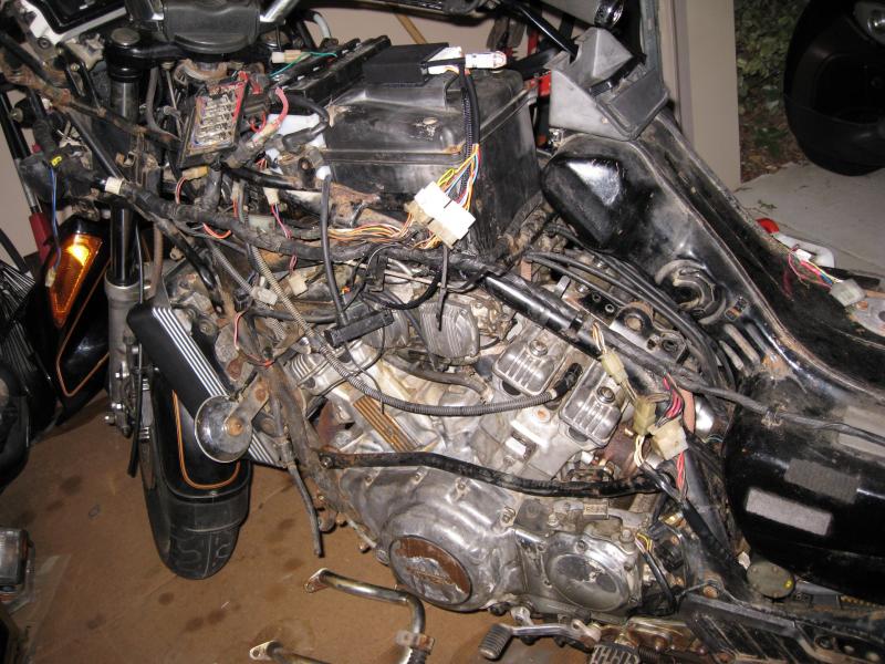

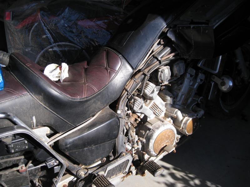

till the tires wear out! Never knew these big Yams were cruiser's dreams. And I just took this in trade for 3 boxes of Honda CL350 parts. See the battery, the car battery, in the right saddlebag?? See the corroded-through rear brake reservoir??
I know I'll never get my money back out of it but it's more about the challenge of it all. I never can stand to see anything, anyone for that matter, neglected to the point where they are written off. Money didn't matter here. Well, not much!
