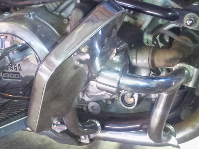

Here's some photo's of the cycle without sidecovers. You can see how far the previous owner took it apart. The motor turned over fine with the bike in gear. I'm really happy and look forward to driving it. Hopefully yet this fall.
