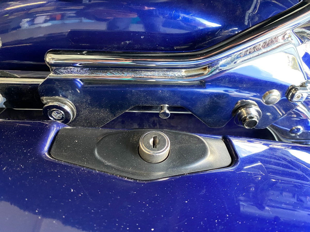

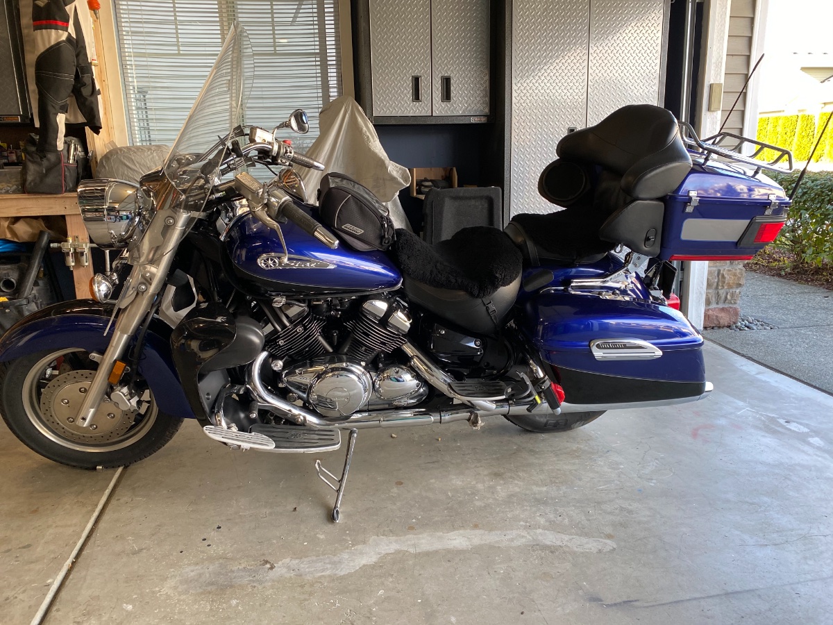

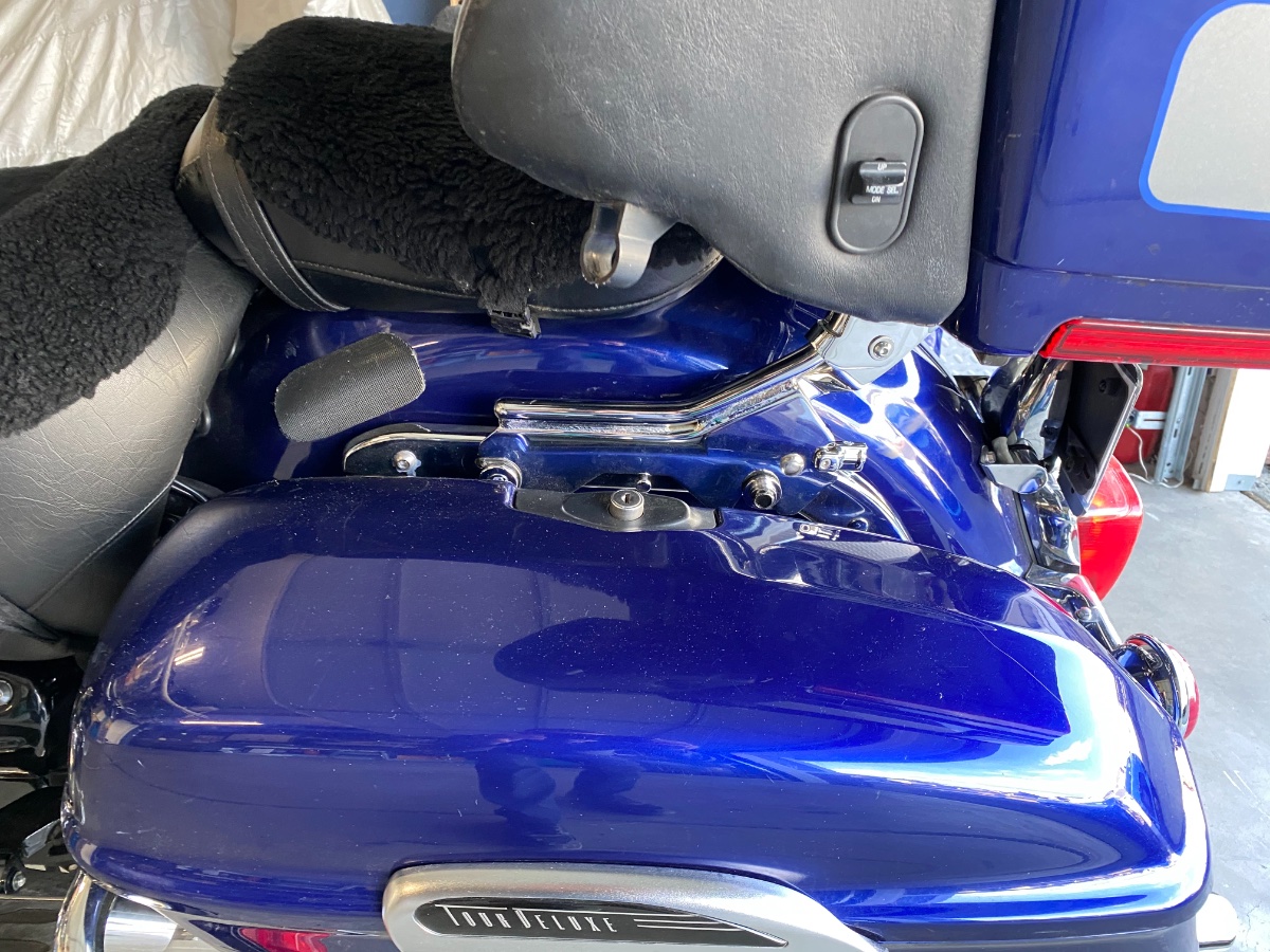

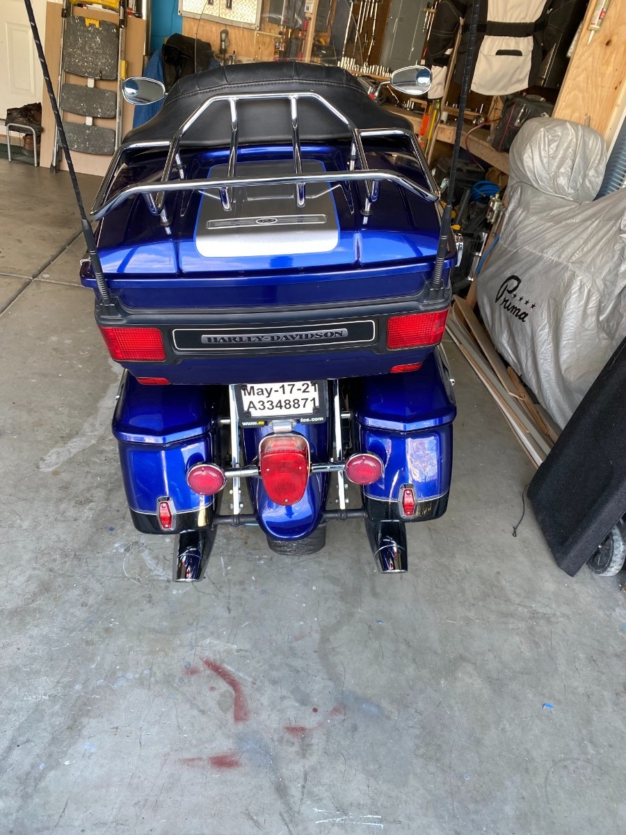

Motoboy51 Posted April 13, 2021 Share #1 Posted April 13, 2021 (edited) Hello all, Well I picked up a 2007 Harley you pack and decided to install. Steps taken: 2018 Harley soft tail deluxe quick release rack with sissy bar, because I had one, but they make a 2 up tour pack rack. I cut and removed the sissy bar. I removed the Yamaha quick release sissy bar, rack-backrest and removed the docking mounts, save. I mounted the Harley docking mounts with x2 long bolts into the rear bolts that hold the fender. I drilled into the fender support just behind the front hole for yamaha dock and taped, install bolts. Then I mounted the Softail setup. At this point you can use some flat steel and mount it to the HD deluxe rack, or if you buy the new 2 up Softail rack, I believe it would slip right on the added docking mounts. Install Harley tour pack and there you have it. Do at your own risk. Thanks Edited April 13, 2021 by Motoboy51 Added picture 2 Link to comment Share on other sites More sharing options...
M61A1MECH Posted April 13, 2021 Share #2 Posted April 13, 2021 Looks good, nice job. I have seen similar done on many Stratoliners and have sold wiring harness to them so the lights on the tour pack work as designed. I can do the same for your bike if you need help and do not want to cut any wires on the bike. Link to comment Share on other sites More sharing options...
Motoboy51 Posted April 13, 2021 Author Share #3 Posted April 13, 2021 Hey, that’s my next step the Harley has a plug with 3 wires. Yes give me a call. 253-561-3206 Josh Link to comment Share on other sites More sharing options...
haup9 Posted May 1, 2021 Share #4 Posted May 1, 2021 Can you still open the side bags with it on there? Might need to do this to mine for the Wifey. Link to comment Share on other sites More sharing options...
