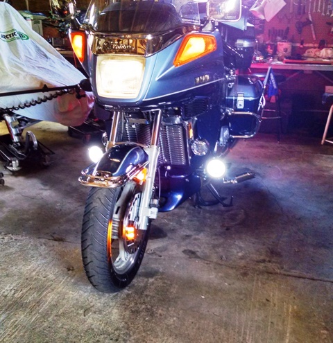

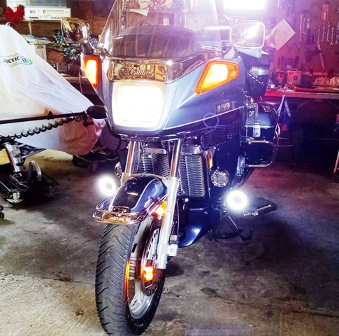

I decided to try some new LED fog lights on my 1st Gen. These are cheap ($30) Chinese (Mictuning) lights, but I figured I would only be out $30 if they don't work.
These have a white LED halo on the outside and a LED spot in the center. They are not true fog lights, since the beam pattern is a spot and not a flat beam. I haven't tried them at night, yet, but they are really only there to make me more visible.
I do like the fact that they only draw about .55 amps each. They are wired so the halo is on with the rest of the lights and the center beam is switched with a relay that is powered with the ignition on.
This is halo only.
This is halo plus center beam.
It is easier to see the difference in person. I will update after some time on the road.
This is halo only.
http://www.venturerider.org/forum/attachment.php?attachmentid=108966
