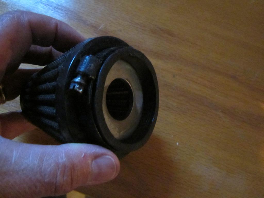

zagger Posted October 17, 2015 #29 Posted October 17, 2015 VerntureVet said: You didn't have issues with the carbs tripping out? Every time I try to take off even just my Airbox cover my carbs trow fits. It's been eight years, so I hope I'm remembering correctly: Each inlet has a machined plate (like a metal washer) with a 1 inch diameter hole to act as a flow restriction. I did calculations on the airflow restriction created by the stock airbox and then calculated what was needed to produce a similar restriction for each cylinder. It should also be possible to measure the pressure drop across the airbox inlet at various rpm's and recreate the same pressure drop with whatever you want to use as the air inlet/filter arrangement. Measured pressure drops are probably going to be more accurate than pencil and paper calculations. I also added Vboost valves (from a Vmax) and found that leaving these valves slightly open improves the engine performance a little bit - not a huge effect, but noticeable via my "seat of the pants dyno". Of course, since these valves allow a single cylinder to breathe through two carbs, they also affect the airflow through each carb and affect the pressure drop across the machined orifice. All this just to ditch the airbox! zag

zagger Posted October 17, 2015 #31 Posted October 17, 2015 (edited) VerntureVet, I pulled off one of the pod filters to show you the flow restrictor - basically a washer with a 1 inch hole. I guess my memory isn't completely shot. zag PS I'm giving up trying to figure out what is shown in your sig pic. Wanna give me a clue? Thanks. Edited October 17, 2015 by zagger
