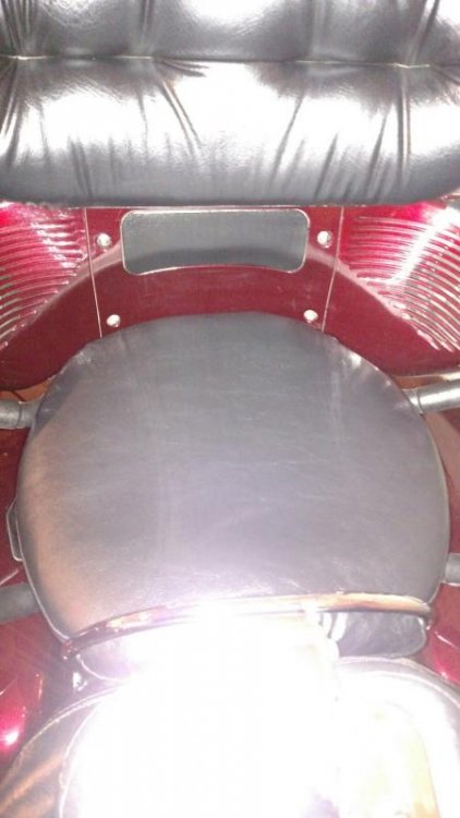

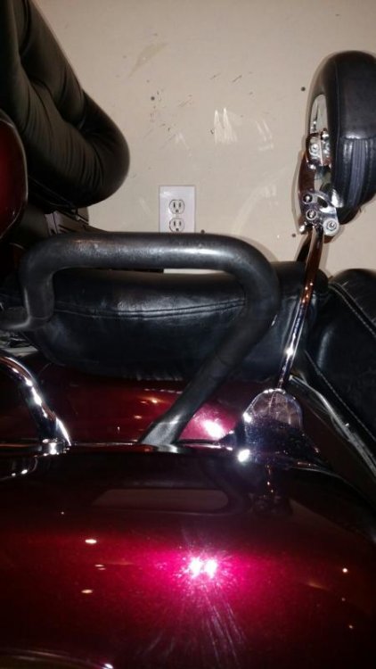

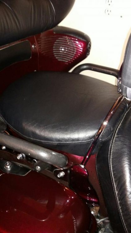

Raider58 Posted April 4, 2015 Posted April 4, 2015 My wife is nearly 6' 1", so I needed to get her out of the jet stream. I purchased a seat off of eBay that was damaged. So abbreviated I cut it almost in half put on a 5/8 inch gel pad, covered with what they call forming foam, then I sewed my own seat cover out of marine grade seat material. It looks and works very well, it got her 3"s lower which is what I was going for all along.

Raider58 Posted April 4, 2015 Author Posted April 4, 2015 Basically I just took the seat I bought off eBay for $35 took a turkey carving knife and cut the original foam about in half, then glued a 5/8 gel pad cut to fit, then covered with forming foam, then my black covering. Like I said it dropped her down a good 3". She says she is down out of the wind now, and says it is a little firmer but just as comfortable.
