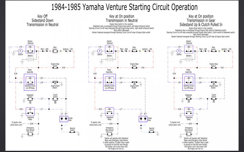

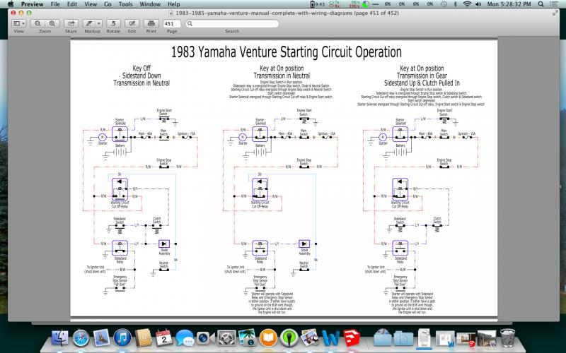

flyday58 Posted March 2, 2015 #9 Posted March 2, 2015 1st Gen Wiring Schematics 1983 - 1993 Try these.
