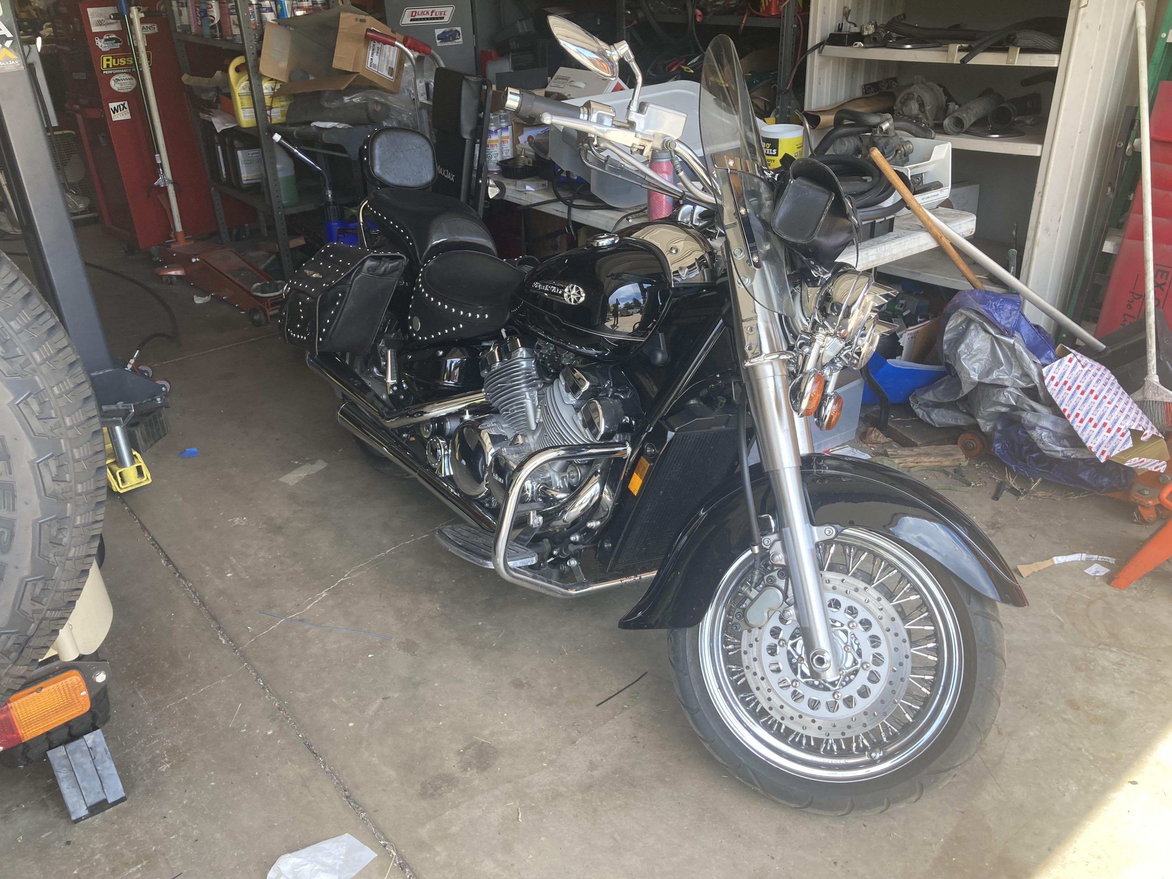

	I'm trying to bring back a bike that sat 20+ years in a garage. Its a 2001 Royal Star Boulevard Midnight edition XVZ13A . It has 2500 miles on it. Carb parts, manifolds, and now I cannot find OEM ignition coils. The aftermarket seems spread thin with junk. New manifolds were ordered and they were of awful quality and too hard to mount the carbs on them. Finally did find OEM manifolds, which work perfectly. I don't want to buy junk for a bike that I cannot get back to health (I am a professional mechanic, just no certification as I went pro in my late 50's). I use partzilla and they sometimes have what yamaha gives them, or sells them. To me this bike is new, but it will never be a classic if all of them are dead. Thoughts? Suppliers? and comment welcome.

	Does anyone have tips and tricks to drop the 4 carb assembly down on the rubber manifolds. I don't like forcing them. The engine is v'd around the crankshaft, and the carbs are in a V setup along the length of the bike, so the manifolds are too close together if you just try dropping them down. Tips and trick. Already tried warming the manifolds with a heat gun..

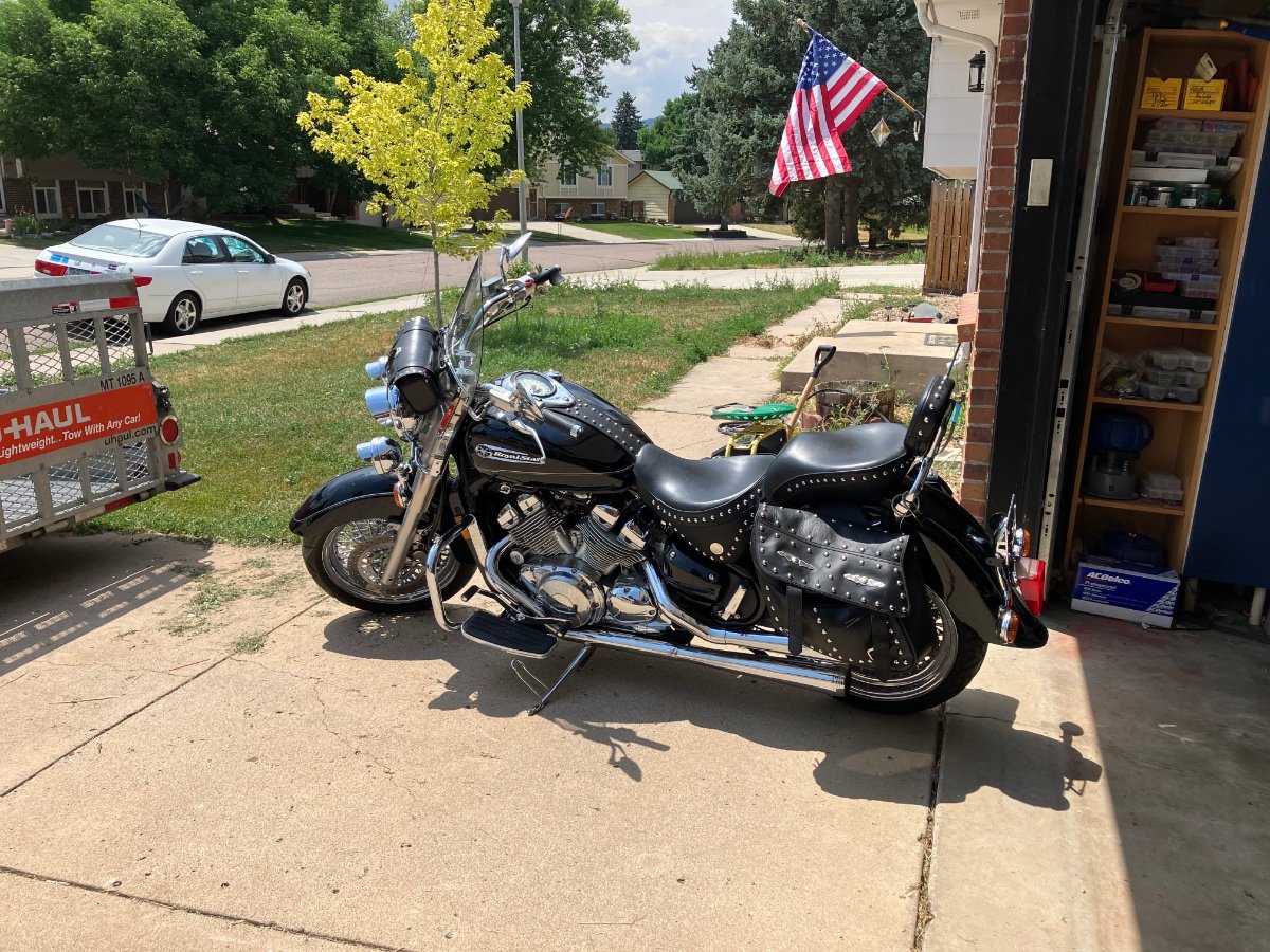

	I joined. I will be contributing, starting with an article on carb rebuilds. But, remember, I am new here (I just bought my bike). Ooh, Ooh, let me post a picture too.

	So I bought a bike to get me back on riding a bike after new knees. Wife loves the idea. I found a Very nice bike for cheap 2400 miles, because it only idled. Wound not move. Im rebuilding the clogged up carbs now, but THEN I need to replace the tires. Rear wont hold air Size rear 180/55 zr 17 front 150/60 zr 17 On wire wheels. Been on bike since new. 4 into 4 bub pipes. These tires seem Too low. I like the big soft tires the bikes originally had. What size (and brand/model if you wish) should I put on these lovely 17" wheels? Tubes?
