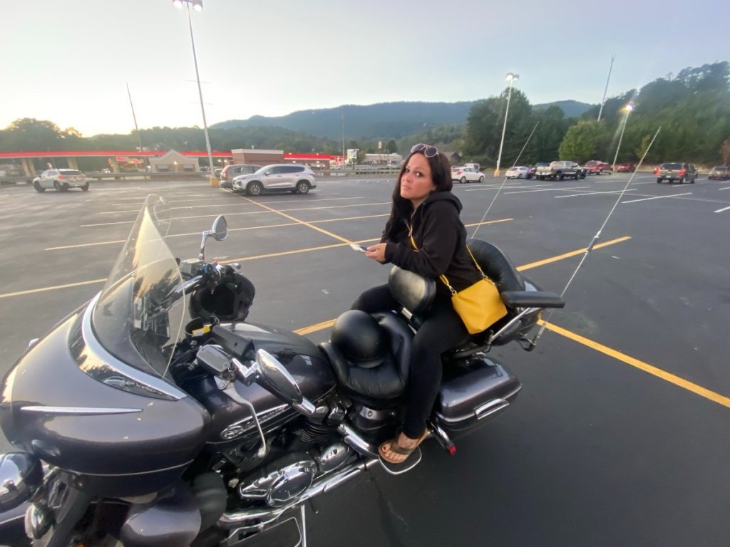

  5. Hey guys I’m Josh Williamson from Tuscaloosa Alabama. Riding an 08 RSV it’s down atm but thanks to some of the amaizing people and information I’ve found on this forum hopefully I’ll be able to get it back up and running end of next week sometime.
