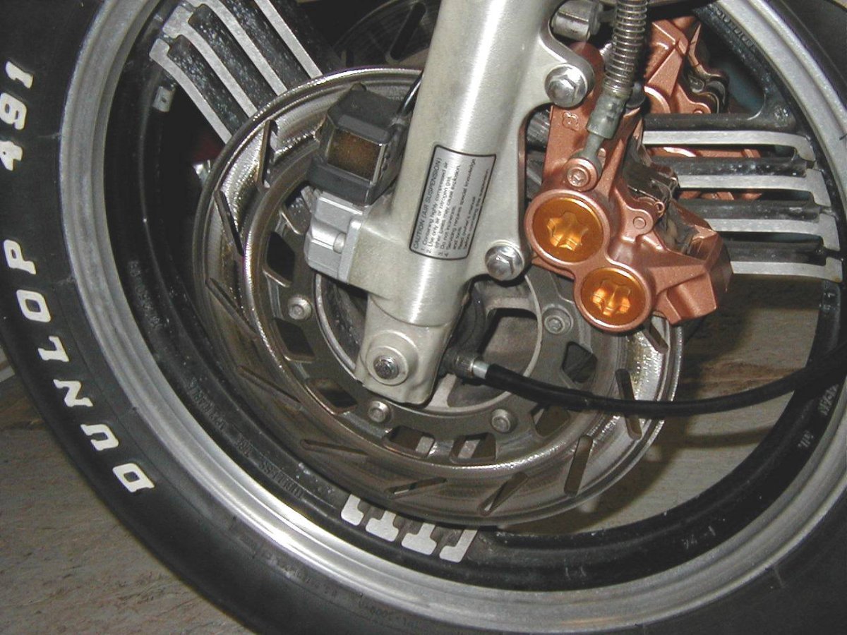

      With you having an 83'VR, the Anti-Dives on the front of your bike are Hydraulic, and require two additional brake lines to complete the S.S. Line Set Upgrade. It's not a problem, I can make up the lines, BUT if this were MY motorcycle, I would find a set of front forks from a 1986 to 1993 MKII Venture for two reasons. #1 is these MKII forks have electric Anti-Dives and you would not need the additional brake lines, and #2 because of the 100mm spacing of the caliper mounts, (Instead of the 80mm spacing on your MKI forks) this opens you up to mounting 4 piston Yamaha R1 calipers on the front of your 83'VR! I also offer a set of Block Off Plates that do away with the Anti-Dives all together when combined with the Progressive fork springs which tighten up the sloppy front end of these motorcycles nicely. As always Ben, the choice to do ANY of these upgrades is solely up to you! But it makes sense to bring the suspension and braking of this bike into the 21st century in my opinion. As I said, I'll sell you anything you want, but I want you to have ALL of the information to make a wise decision about the direction you are going with your bike. If any of this sounds interesting Ben, lets chat some more and get a game plan together before you start buying parts. I sorta' jumped the gun and assumed that you are handy with a wrench, and are going to be putting these parts on yourself. If this is not the case, let me know, and we can scale down the mods to fit your ability and go easy on your pocketbook. Having a bike shop do Anything to your 38 year old motorcycle is going to cause you to dig deep into your wallet, so keep that in mind. I attached a pic of the R1 calipers on my 87'VR! I have front forks if you can't find any.
