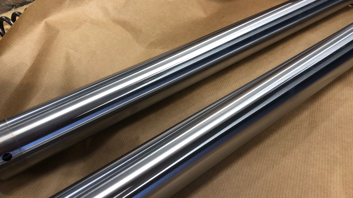

  1. Yes, after re-chroming they are made to the original specs (using a Lathe). Everything fits perfectly: no leaks!
  2. They're back and like new! Rebuilding the front (again )..........

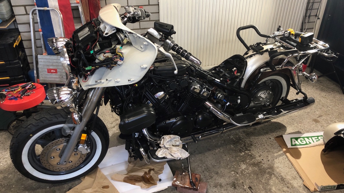

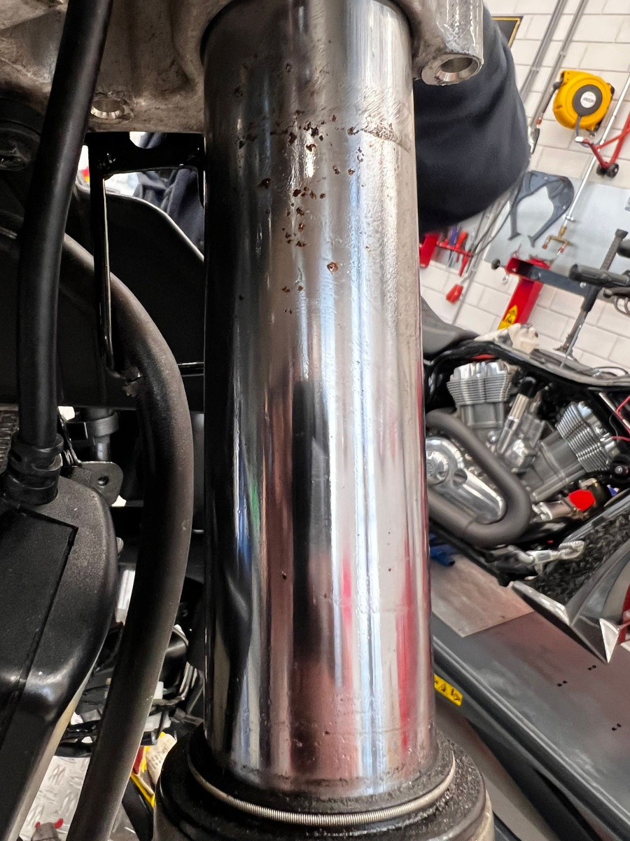

  5. 2 issues: - the front suspension is leaking (both sides) - the carbs are still not 100% So the motor surgeon can do his thing next week! Ready for ER:

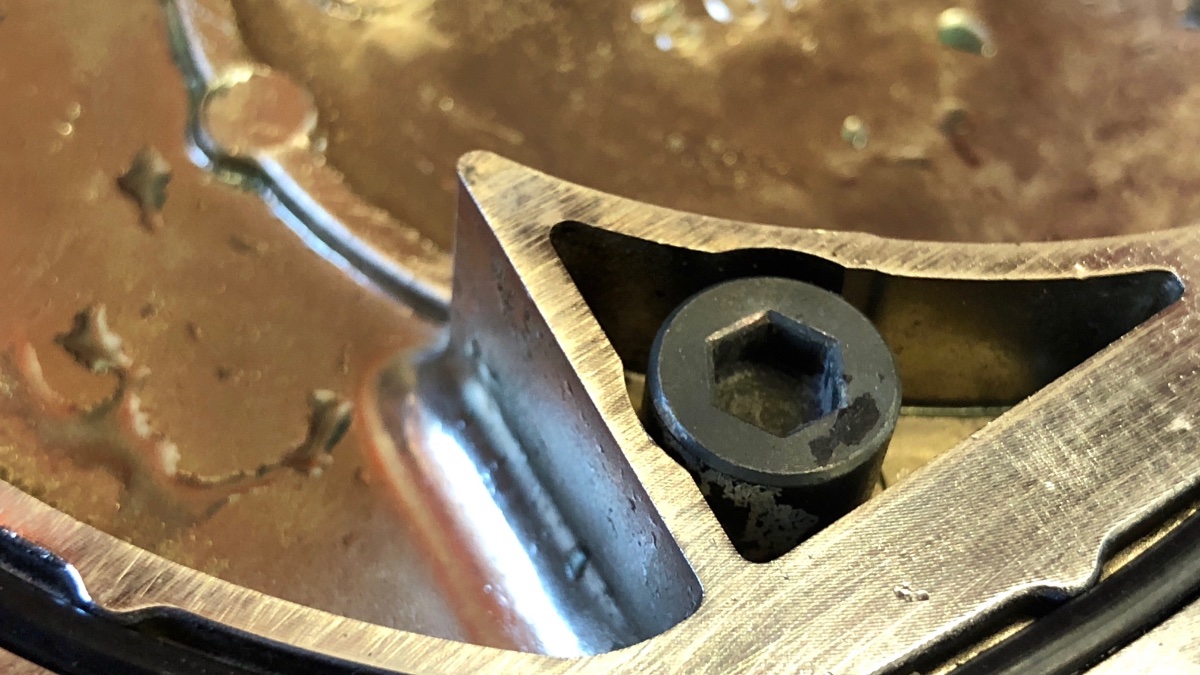

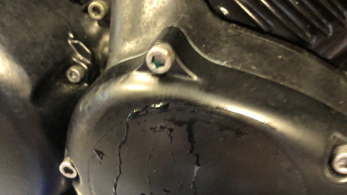

  8. I ordered a used water pump cover in the USA and received it today. The part was 9 bucks and shipment 23........... It was all about this bolt, cleaned it and mounted it. Part number unknown....... But we're on the road again!
  9. Thank you! Without the tube/bolt in the cover, the pump cover will leak between the round plate on the front and the cover housing unfortunately. The round plate looks like an escape route for the coolant when the pressure is getting too high.

  11. We're missing a part from the water pump cover. Clymer and CSML doesn't show the part on their drawings. Any idea? On the left is our cover. Have a great weekend!
