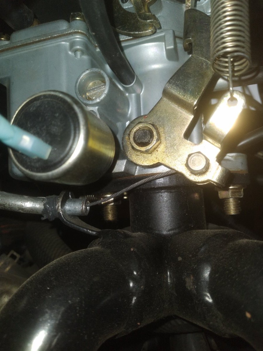

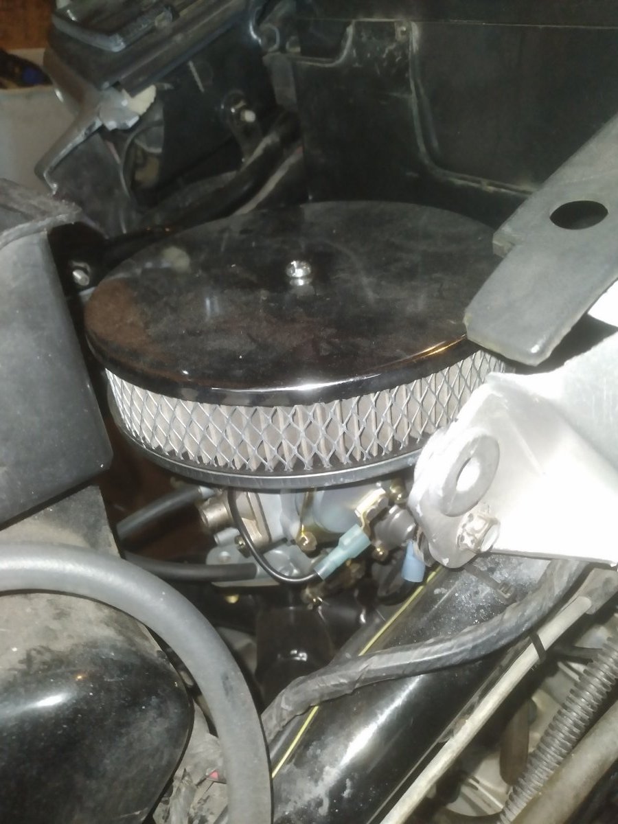

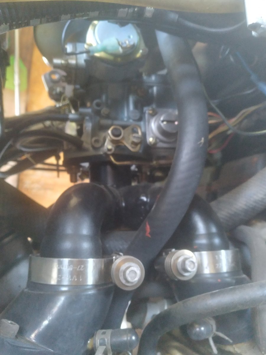

https://picclick.com/Yamaha-Venture-Xvz1200-1300-Single-Vw-Carburetor-Conversion-254019228752.html Here is a link to get you started. Mine was a little cheaper only because it didn't include the air filter. Shop around and u may find a better deal. You will need to buy different clamps that are more heavy duty. I got my clamps at a NAPA store. Here are a couple pics. I have to say it was the best investment I've made on my bike. Love the electric choke and fuel shut-off! Any questions, feel free to ask. -
Got it through ebay. Manifold and carb together. Fairly easy setup. Picked up some heavy duty clamps. The originals won't work. Also got a small chrome air breather with an outlet for the crankcase breather hose. Connect the choke and fuel shut-off to the accessories screw. I connected the ground to one off the float bowl screws. The carb has 3 vacuum outlets. Connect one of the bottom ones to the the vacuum advance. Then I just looped the other bottom one the the one on top. Notice that I set the accelerator pump screw up 2 notches from the bottom. Once it was all hooked up, I watched a Volkswagen beetle YouTube video on how to set the carb screws. Only need the pull throttle cable. Hopefully the pic will show how I connected the cable. I zip-tied the choke and return cable up out of the way. Such a joy to go out, give the throttle a twist and here the choke engage 20230611_192400.mp4
