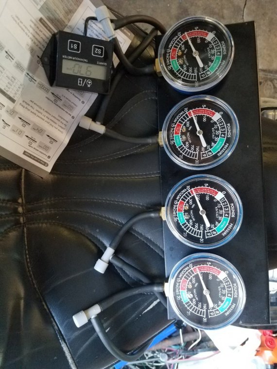

	Okay for giggles I turned the pilot screws in. They are fully seated and the bike is idling fine..... I was able to see a vacuum change on cylinder 4 from fully seated to about 1/4 turn. The other cylinders had no change in vacuum. I'm thinking the bike is running way too rich, I forgot the vacuum caps after I pulled guages off and the bike was still idling fine. It was a slight boggy and when I cracked throttle it died a couple times. Is there anyone on here that specializes in these carbs? I already spent 400 to get them rebuilt. I dont think they need a full rebuild again. But I'm just curious if something was rebuilt wrong.

	Okay I have the new valve shims in, new cover gaskets. All is back together. I synced the carbs. It is hard to get started cold. The backfire is not as bad now. I only get it when I twist throttle too fast. At first I saw flame out of the exhaust, I have turned the pilot screws out one turn. No more flame, just black smoke on backfire. According to the vacuum guages I should be getting higher vacuum. I read somewhere that the only way to adjust the "timing" is to adjust the TPS on the carb. Should I worry about the low vacuum or leave it as is as long as carbs are synced. Should I turn the pilot screws out any more? The bike idles like a champ. It's so close to be ridden. I'm just worried about this backfire to take it out on the road.
