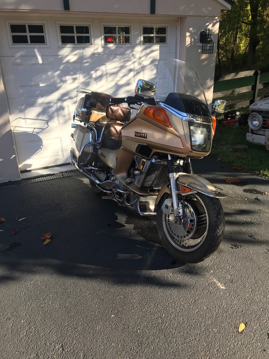

  3. Hi guys. Before we get to the obvious: yes I know this is a unified system and I understand how that works. Here’s where I am on my 1984. I had to replace a frozen rear caliper. No issue. Went to bleed the system starting at front left anti-dive, and there was nothing there. No air pressure, no fluid, nothing when I press the pedal. Same at front left caliper bleed screw. Nothing. So just to check, I was able to bleed the rear caliper like normal, no issue. I pulled the front hose banjo fitting off the rear master cylinder and confirmed fluid and pressure when I pump. So, the question is why am I getting nothing to my front left with a good master cylinder? And how do I fix it? thanks
  4. 1984 Venture Royale Gold JYA41 V006E A0002 37 Manufactured 11/83 odo 69,000
