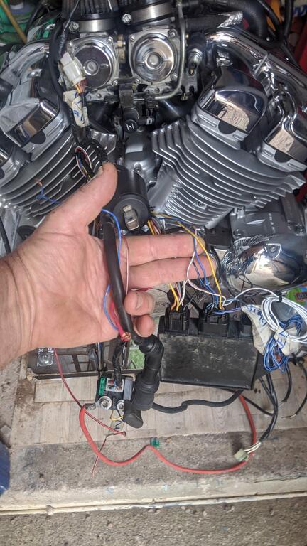

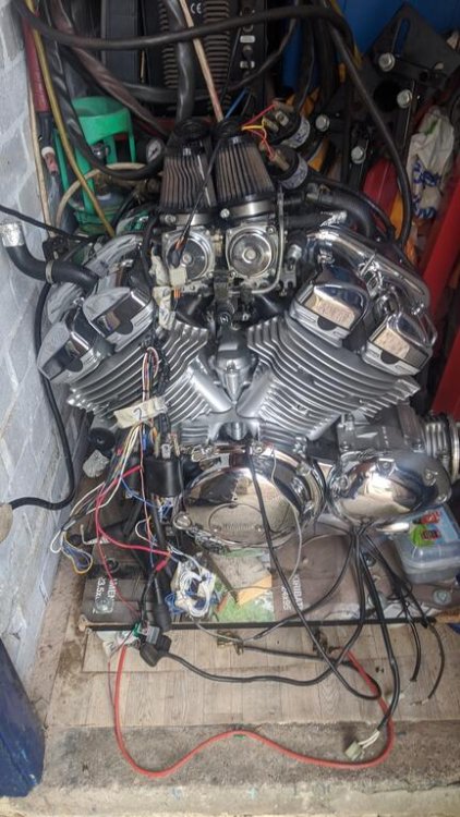

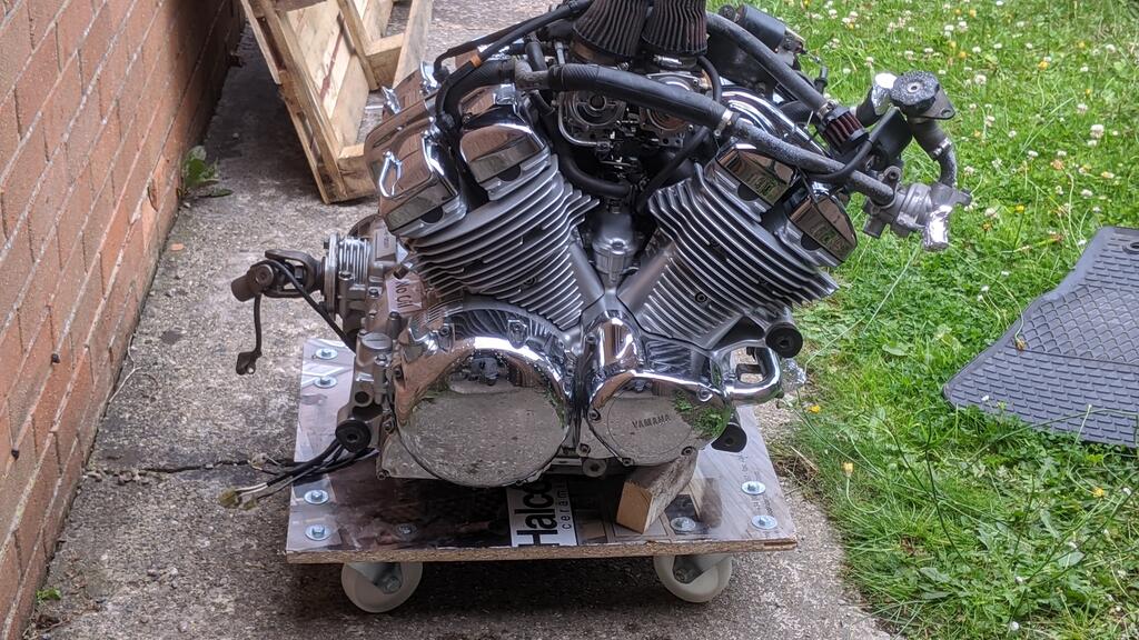

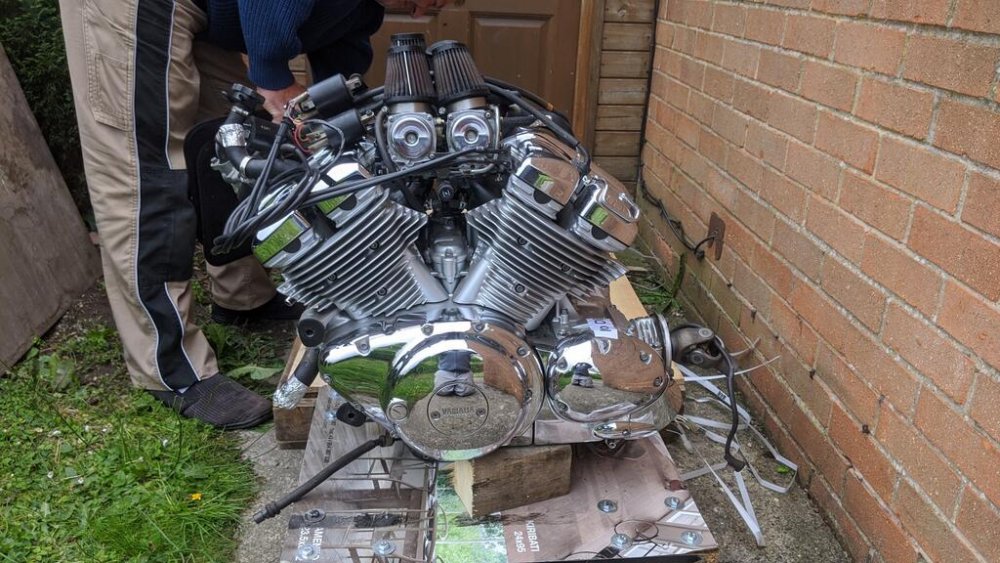

  2. Hi thanks i found that and had it printed LARGE so i could follow quite easily, crank sensor in place, in nutral, jumpered cutoff box. wiring at moment just looks a mess, did order a cut off box and loom from US but loom came with x number of pins and cut off box came with one more pin so didnt fit, used parts for Royal star are twice price here in uk so cheaper to ship over pond and pay postage, duty and handeling charge, may have to order another loom and igniter and start with complete loom and remove one wire at a time untill it stops sparking Steve

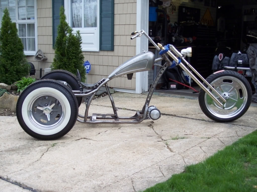

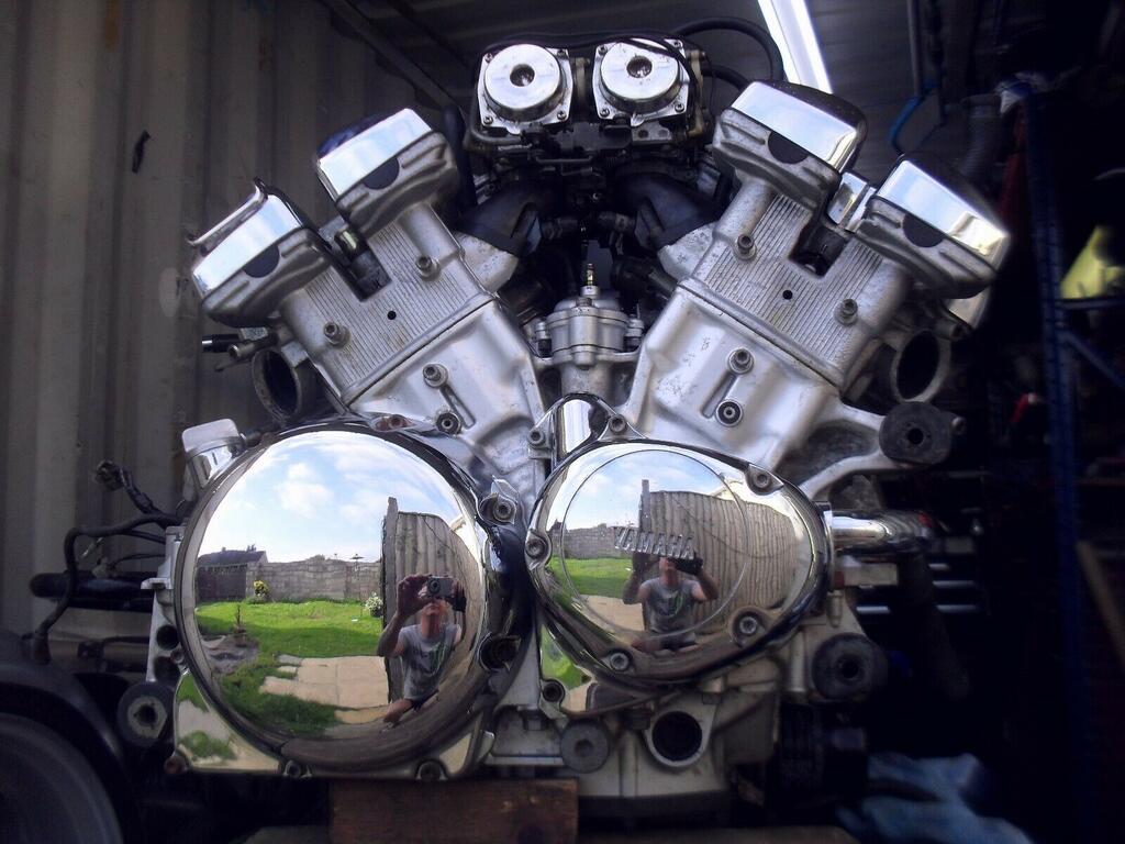

  3. HI ALL The names Steve Im a retired engineer, with a love of making stuff, I have built (converted) trikes and built tube work buggies for years, now im retired i have a special project i have been dreaming of for years, I want to build a trike from scratch, I have bought a very low genuine milage 4k 1999 royal star engine, last MOT UK road worthy test last november 4140 miles, that has been jetted and a modified clutch fitted I wish to build a frame something like this for it really didnt want to use harley motor saw a royal star and knew that was motor i wanted to use here is motor Has any one got a cut down wiring diagram to get motor to run as a stand alone unit with minimal wiring, I have stripped a loom to what i think it needs acording to a wiring diagram, i can get it to turn over but not spark, i have the ignighter i sure i have bypassed all cut outs etc, just wont spark, not worried about it running it will run if it sparks, so for all the keyboard warriors, I dont need wheels, radiator, headlight, or even furry dice hanging from back please if any one has put a royal star in a chop or something please tell me how you got it to run Thasnks Steve
