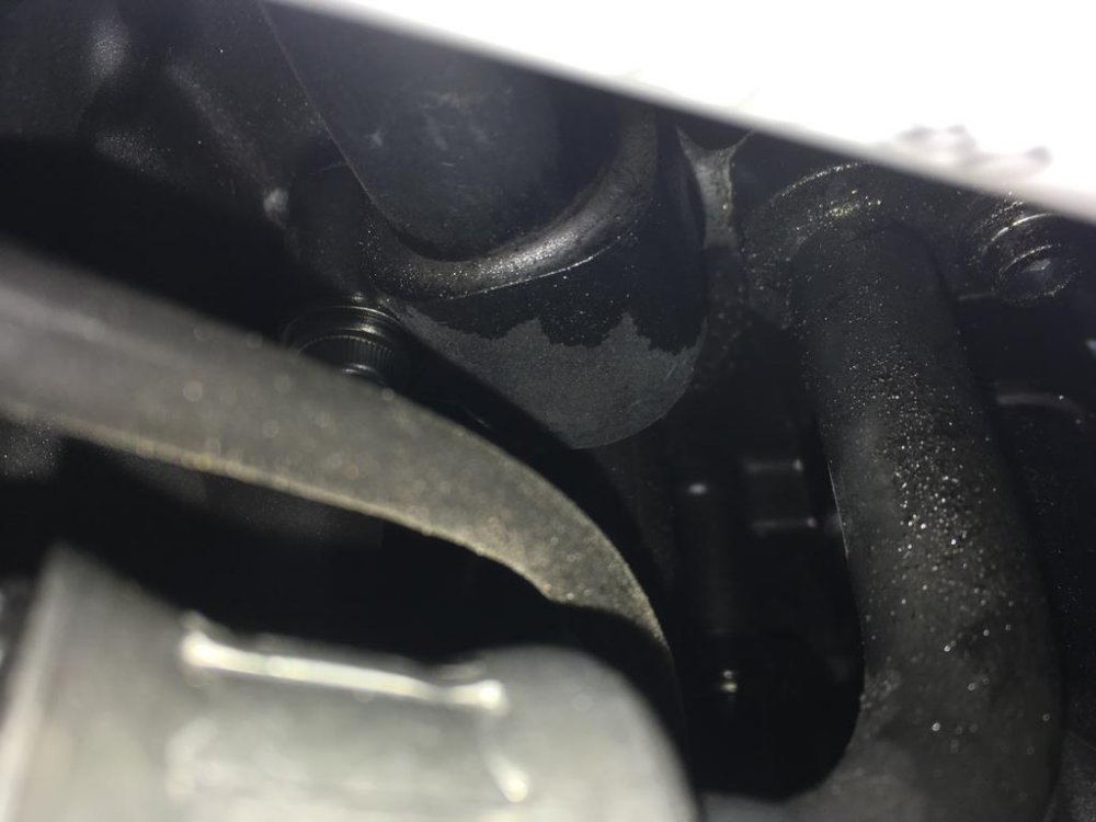

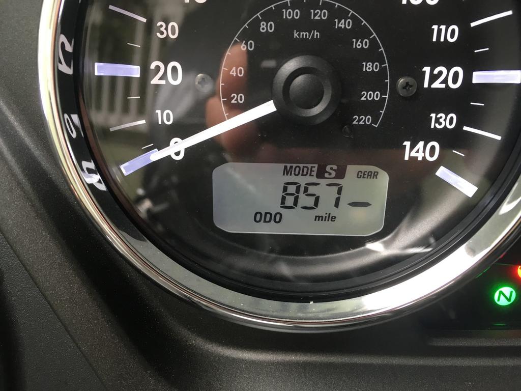

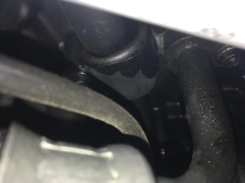

	Brand new Venture Leaking OilPGR replied to PGR's topic in Star Venture and Eluder Tech Talk ( '18 - Present) My bike is still leaking oil. I can't tell exactly from where, Right side directly above the VIN# tag. It then runs down the side and under the engine case. At this point the bike has 857 miles on it. Wednesday I am taking the bike back to Moto World for the last time. I Am contacting Yamaha and at this point I want another bike or my money back. This picture was taken holding the camera under the right side of the bike facing straight up.
