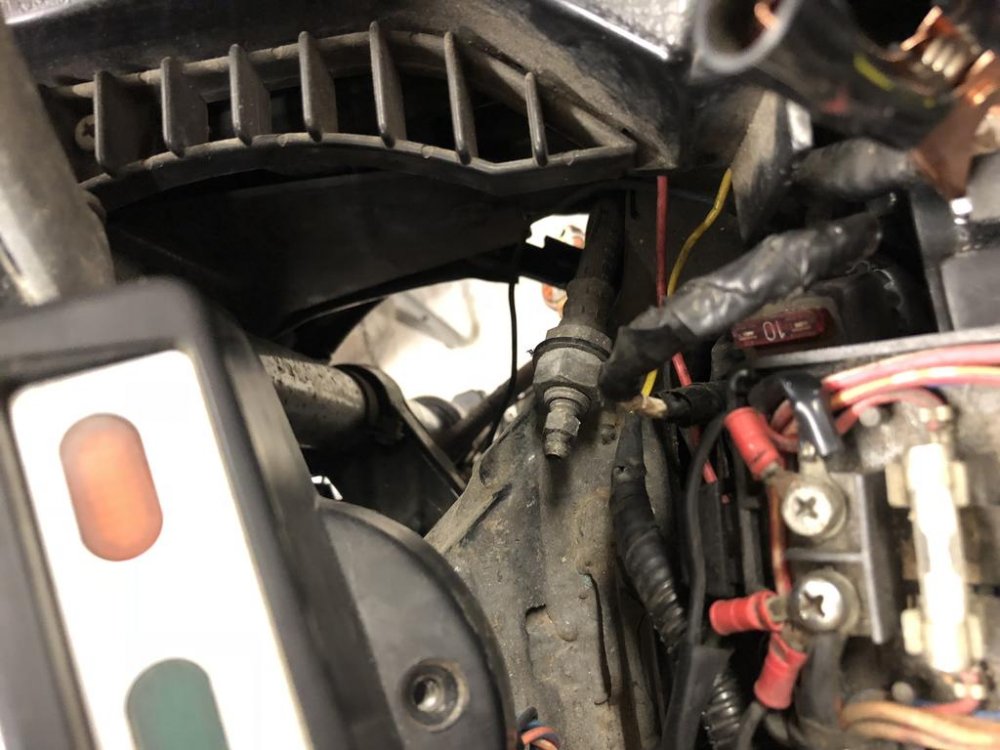

  2. Well thanks to Puc I found the sending unit and the temp probe. My wire is green, but I took it off and shot some cleaner in there and popped it back on. Took her for a ride today and still no luck. Hmmm...

  5. So is it the wire that is attached to the solid ‘probe’ on the bottom of this part? I know folks said it’s a blue wire, but mine seems to be green. I popped the wire off and shot some cleaner up in there and put it back on. I’ll fire it back up in the morning and see if the gauge reads once warm. ‘Thanks again all’!!

  7. Any chance you guys can post a pic of this? I noticed my temp gauge isn’t working either and I don’t know what or where the ‘sending unit’ is. Thanks in advance, tim
