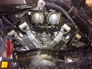

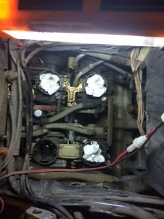

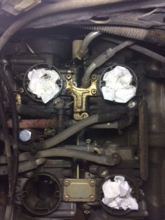

Found a frayed throttle cable, easy to replace? Looks like they're not budget busters. I'll do a write up with what I found/used for the carb rebuild. Need JIS screwdrivers, need k&L rebuild kit (has both jet block and choke block gaaskets), JBM makes new diaphragms which don't require the two plastic washers (they're new and $20/ea so you might as well buy them now and hoard them). My slide diaphragms were pinholed from folds on 2x carbs (haven't got to the other two yet) and the pilot was like most I've done, easy to just use extractor to bring it out rather than maul the slot. Did round a few screwheads before i found out they were JIs, irwin extractor kit + drill worked well as always (great investment at ~$30). Air passageways were oiled up and also full of yellow gas. I had tried running "Mechanic In A Bottle" through the system and it is apparent that the solvent was dissolving the junk by the plethera of yellow gas residue, just couldn't get to the air passages. Will prob do a puke bottle in the airbox for the crankcase ventilation.
Thanks guys, I appreciate it. I looked over the setup last night and it looks like there's only two cables visible and a few simple lines. Should be easy. I figured I'd take a whole bunch of pics so reassembly is easy. Does anybody know if the carbs for a v max and venture 1300 cross over, might be cheaper to buy the v max label than the venture label? Thanks on the carb rebuild, might have to do that if I get sideways during the rebuild.

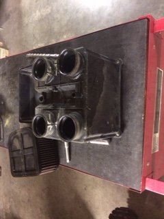

Got a '89 with ~55k miles for $1k in really good condition. Wouldn't hold idle without choke, bogs a little when you get going. Guy said he ran some cleaner through and it got a little better. I bought it and it sat for a month or so and has been a little worse, but now really stinks like gas (exhaust too) when idling with choke. Bogs pretty bad on acceleration. Would just try cleaner but I pulled the air box off and it really stinks up top of gas. Two carbs (left side as sitting on bike) even had a little gas visible. The motor and carbs on tje left side are really dirty and oiled up, but I'm thinking they're from gas leaking. Make sense or is a known problem? They look easy enough to pull out and I'll clean them once out. No problems with ultrasonic cleaners? Is the oily dirt due to valve cover gaskets or some sort of leak in the carb? Are the jet looking screws visible from up top leading to bowl (as in can I drain bowls and blast cleaner through in hopes of getting to pilot?)
