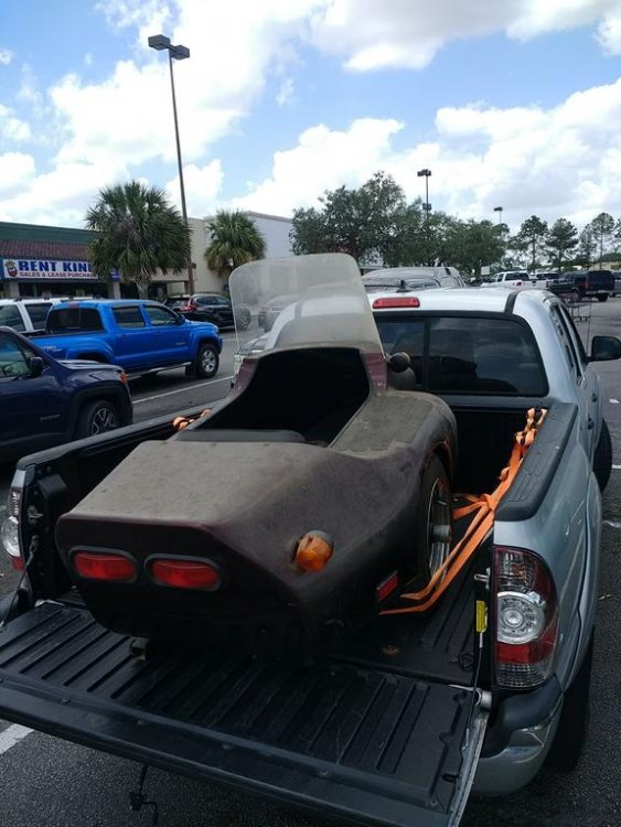

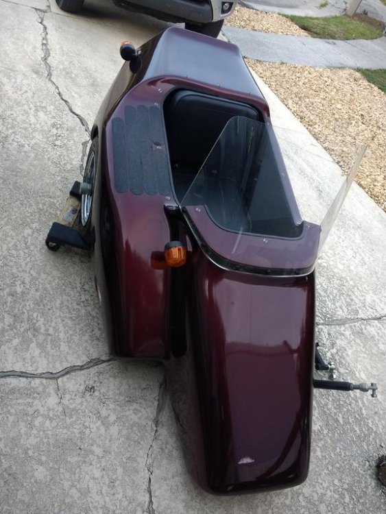

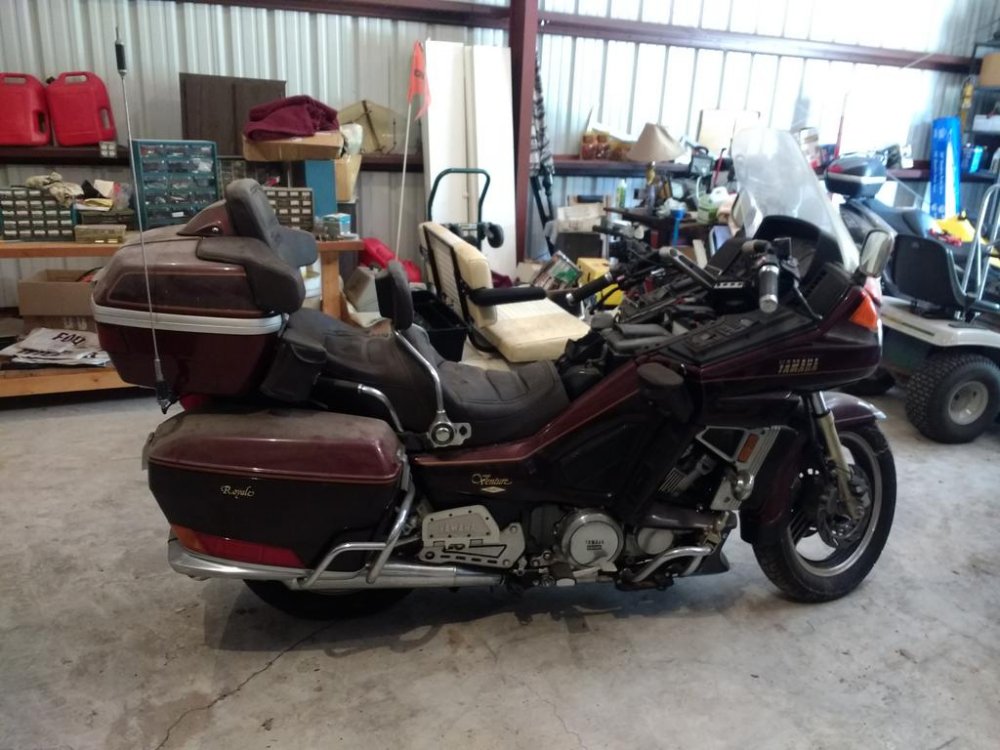

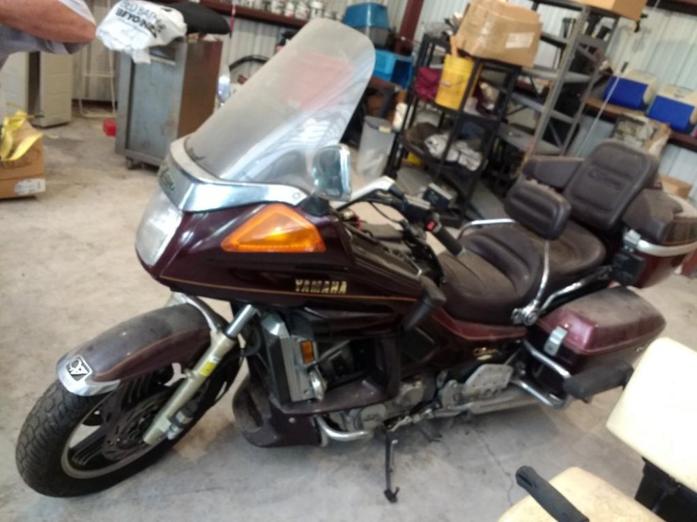

	Hi, I just bought this barn find 89 Venture Royale with a sidecar for $500. My first instinct is to try to get it running, so I'll be spending some time in this forum. If that doesn't work, I'll be parting it out. My only previous experience has been with a KLR650, so I'm way out of my comfort zone. The previous owner said he last started it 6 years ago when he drove it back from a mechanic who said he could not find parts for the air suspension, and supposedly that was the only thing wrong with it. We'll see. I couldn't even take it home, because I didn't take my trailer, but I paid for it, and I have to figure out how to bring it back home. Here are some dusty pictures.
