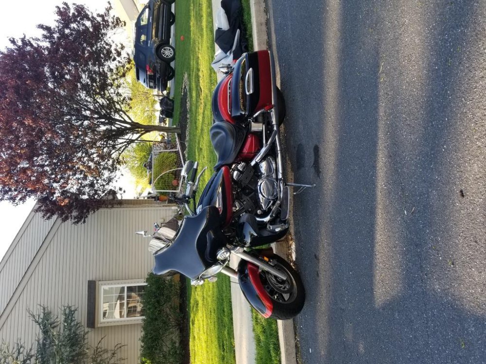

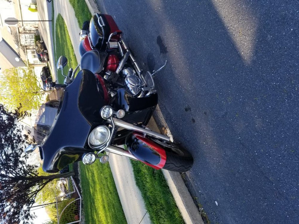

It's a trailer store USA fairing. If you have the OEM windshield the fairing becomes quick release. The overall quality is pretty good. The only issue that I have is the stereo section doesnt line up directly with the speedo without looking awkward. There is about a one inch difference between the face of the speedo and the fairing. I'll take a picture and try to upload it

Thanks. I'm not sure why the pictures turned sideways
