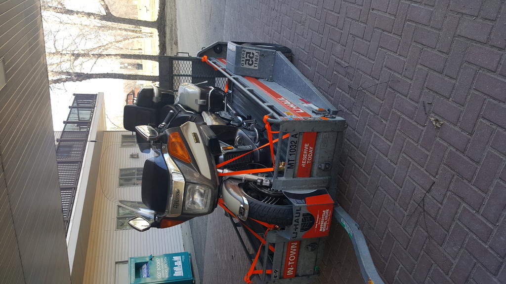

	I'm pleased to announce, she made it the 230 mile trip without incident. now time to start getting her ready for the season.
	:thumbsup2:It was pretty windy here in Chicago too:group cheers:
