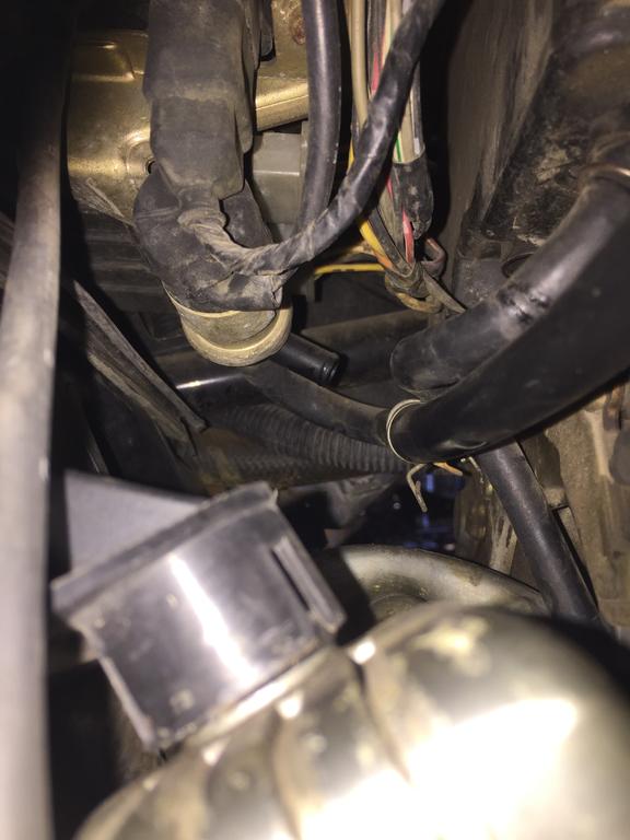

	that image is definitely not the fuel pump...my pump is factory and near the left rear footrest. No one has been able to tell me exactly what that component is but others with an 86 have the same setup....as for the canister, I pulled the line from the carb and put a bit of pressurized air down the line into the canister and it spewed fuel out of the nipple in the bottom so I know it's not full of fuel...just had some in it. Does that make sense?

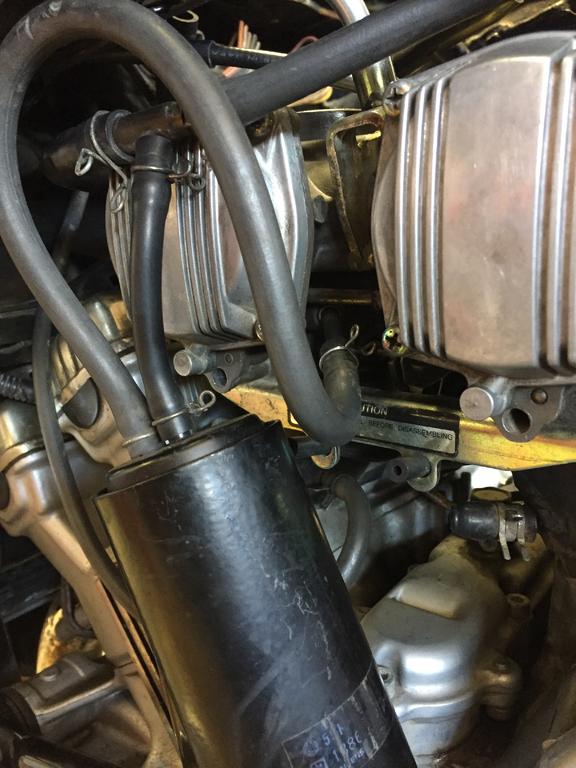

	The larger hose is connected directly to a large nipple on the bottom of the front carb (not the drain). The other carbs don't have this nipple. The other line Ts and runs and runs to 1) fuel tank vent and 2) the carb vents (which also T into the brass cylinder pictured in the 2nd image). Also worth noting when I've tried starting the bike when it was exhibiting the problem I've seen the nipple on on that brass cylinder actively SPEWING fuel onto the front cylinder bank (that's the front cylinder bank at the bottom of the 2nd image).

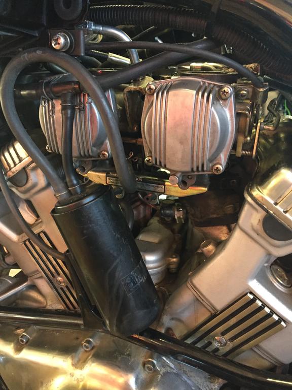

	Here is the offending canister. There is an open nipple on the bottom that is dripping onto the frame rail. Here's some history. Bought the bike in early Winter. The carbs were about the only thing that weren't giving me problems. The engine ran great for a while. I decided to treat it to some Seafoam in the fuel. A few days later it didn't want to re-start after being warmed up. It became evident that it was flooding (at this point I didn't know if it was one or all the carbs) so as was mentioned on the forum, I figured it has dislodged something into one of the seats. It did flood badly enough to hydrolock once which scared the crap out of me. The crankcase level never seemed to change in the sightless so I didn't change the oil. Pulled the carbs and carefully went through them per AndyE's detailed write up. Replaced the needles and seats with K&L sets. Set float levels (according to specs found here) and reinstalled. Ran the bike and it flooded on all 4 carbs badly....spewing fuel up out of the air bleed jets...I figured that I had the float levels wrong somehow. Re-pulled the carbs yesterday and set the float levels lower (1.125" inverted) and re-installed. Ran bike static in the garage for 1/2 hour and re-started several times....no fuel pump cycling and no flooding! Yay, right? Nope. Ran the bike for a mile and started bogging badly. I thought maybe I'd fouled plugs so made a plan to change them when the bike cooled. Managed to get it home and shut it down....let it sit for several minutes and flipped the key. The pump still did not cycle and still no flooding! Yay, right? Nope. 1/2 hour later I went in the garage and theres a puddle under the bike. I didn't even get to witness what in the world the problem was but that canister has fuel on the bottom nipple. I pulled the line that goes from the top of the canister to bottom of the left front carb and its moist with fuel. Flip the key and the fuel pump cycles several times.....Hope that helps in some way and I do appreciate the help you guys are offering but I'm losing trust and faith in this thing fast....
