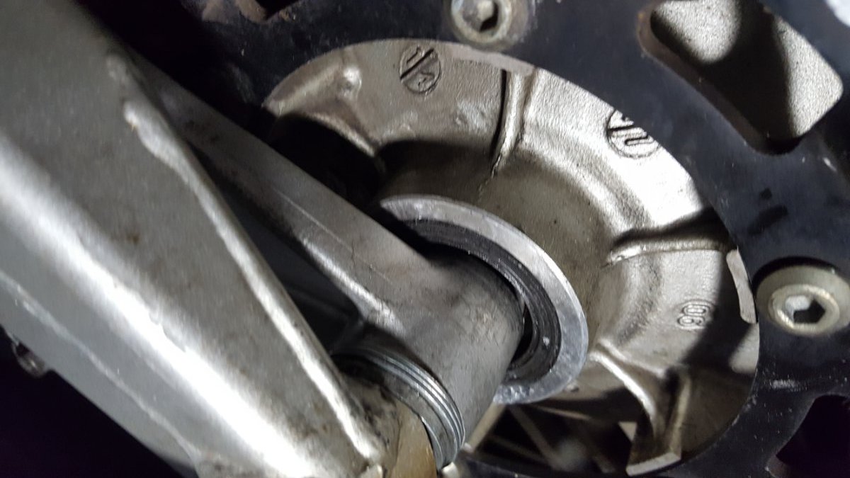

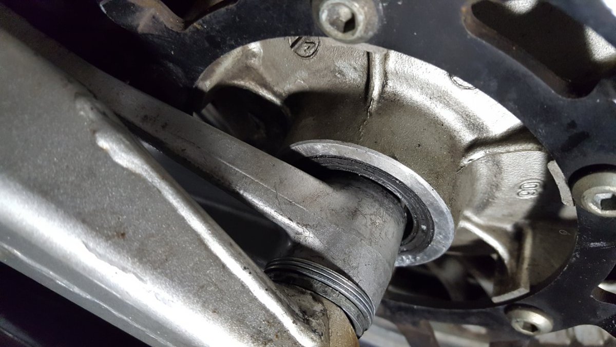

I went back and took off front wheel and then rear wheel. Replaced everything, making sure to put spacer in correct spot and wheel still does not move freely. It seems almost as if the brakes are on. Spencer, the amount of axle shown in your picture is when everything is torqued to specifications? My axle goes in past the holes in the axle.

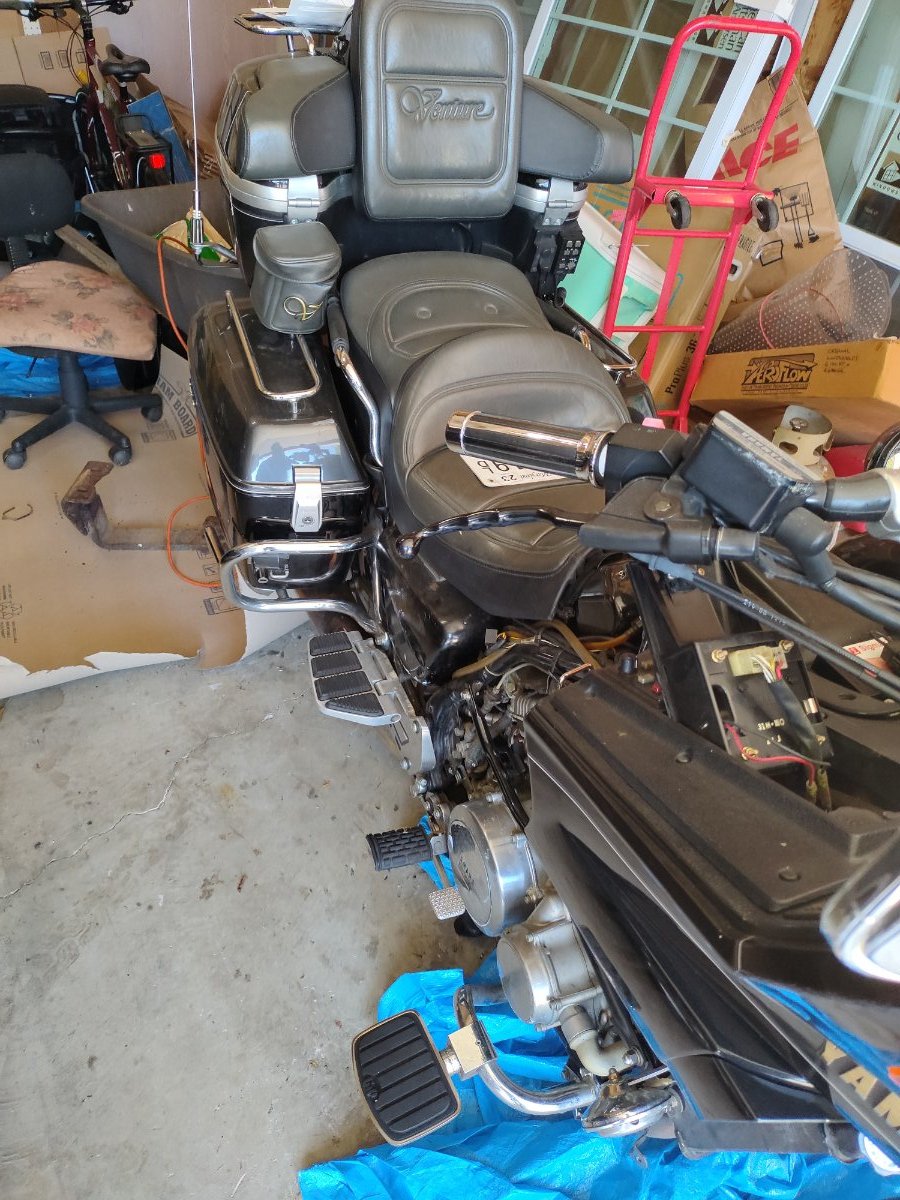

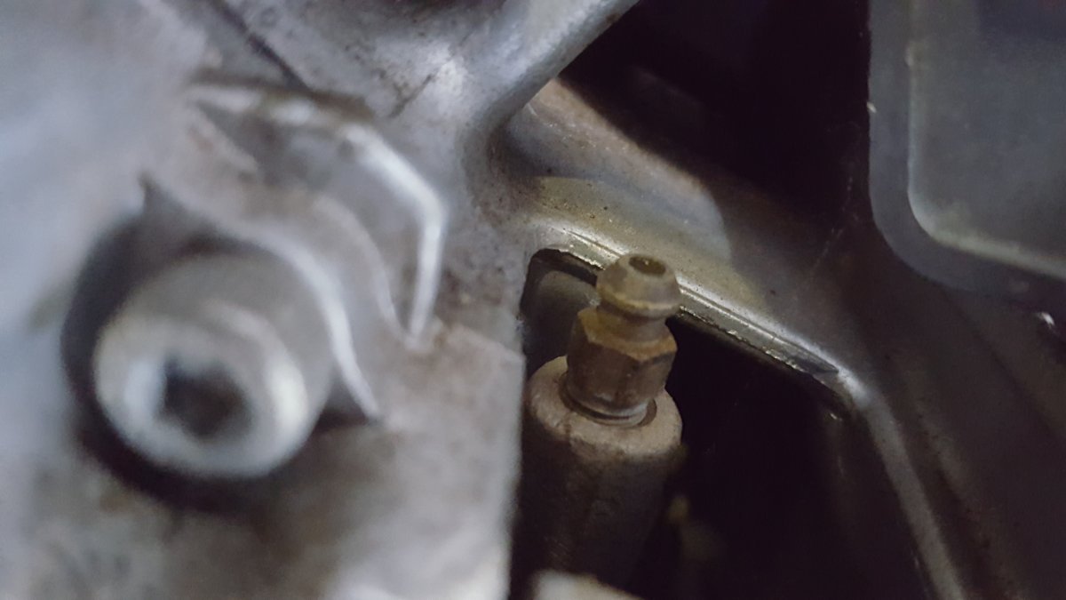

Well I finally got some time to work on the bike. Using all the useful information posted, I was able to get both wheels off. I don't know why I was so worried about not having enough clearance. Once I removed the from wheel, the rear wheel was way up in the air. I had some difficulty removing the cotter pin but ultimately was able to get it out. Also had some difficulty getting enough leverage and clearance to remove the final drive bolts. Tomorrow, a shop will mount and balance my new tires. Attached are some pictures. I am sure I will back asking questions when I am reinstalling the wheels. Thanks for all the good advice. I would not have gotten this far without it.
