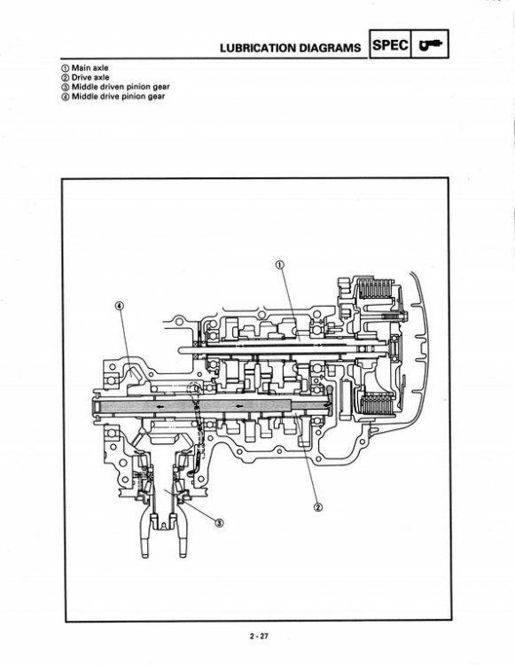

So, We got the new clutch boss in and that side of the engine back together. While we were waiting for parts to come in I was thinking, why would this bearing fail and why did it get so hot? I wondered if there was a lubrication issue. I figured that once the clutch was put back together - prior to re-installing the output shaft - I would get under the bike and have my son start it and I would watch inside the middle drive area to verify that I could see lubrication happening. I crawled under it, he added oil, started it up and I watched... Now, I honestly do not know how it is lubed. I have downloaded and printed out the service manual. It appears the oil travels down the drive axle (Lubrication Diagram page 2-27) towards the middle drive pinon gear. I did not see the pinon gear (no.4) getting lubed. In the diagram, about halfway down the drive axle (no.2) it looks like it heads towards the middle driven pinon gear(no. 3) or what I am calling the output shaft. It makes sense that the bearing on the output shaft would get lubed this way, however, looking into this area from below, I saw no oil flowing while it was running. I assume that I should see it lubricating the shaft, and I saw no oil flowing near the area that the output shaft o-ring would seal. I have uploaded a picture I got from this site to show the area I am talking about. My question is this, - Could I have a weak or faulty oil pump? Could I have a clogged oil passage somewhere? Thoughts?Oil flow chart.pdf -

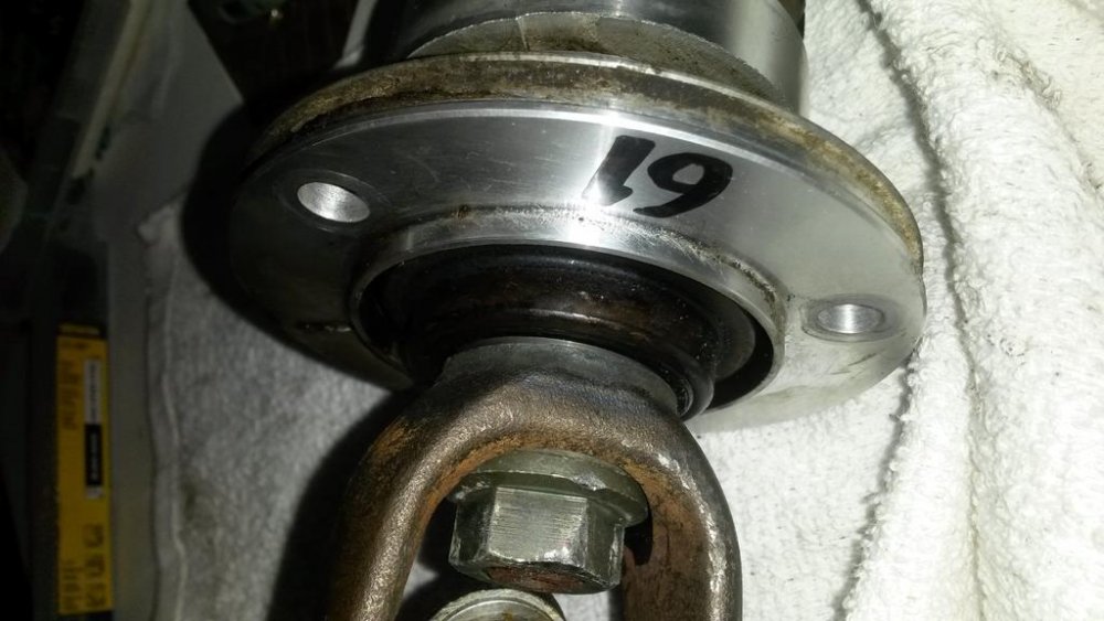

Wow! You guys are awesome!!!! I knew there was a reason I renewed my membership. This is the Dad here now. So, Like he said before, He pulled the rear brake, dropped the rear wheel, pulled the final drive, pulled the clutch basket, everything did not show signs of the problem there. While the basket was out, we were able to look in and see the transmission gears, shifting drum works correctly, minor movement in shaft, gears etc. Concluded that the internal parts were as close to functioning correctly as we could deduce without opening up the case. Next we talked it through, had a conversation with Mike the Guru (diamond cut guy) and headed towards the output shaft. I figured if stuff was turning on the inside, it had to exit somehow - and the output shaft seemed like the first place to start. My son pulled the swingarm and then the output shaft - it is seized. It smells like it got HOT. I even see tempering color at the base of the yoke. I am thinking that is the problem! I assume there is a lubrication problem - Any ideas why? Also, I see the number 61 on the flange. Is that the thickness of the shim? I see an output shaft on ebay that has 73 on the flange. Is there a specific way that you set the pinon tolerance? Again, Thank you guys for all the help and ideas. -
