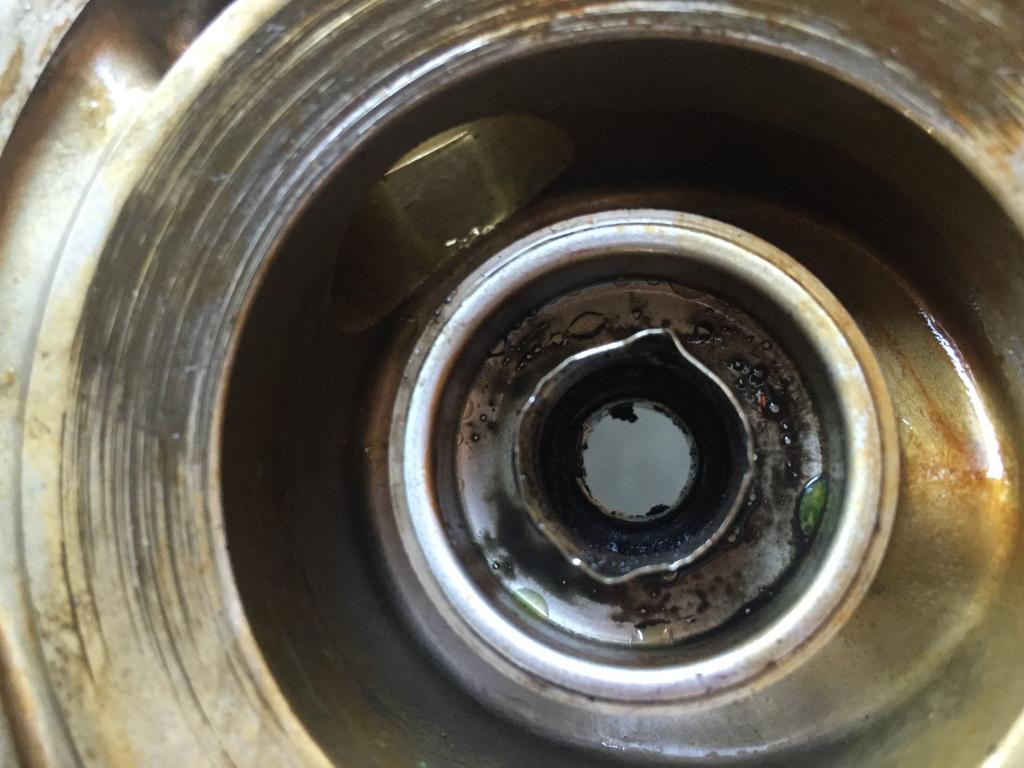

	ok is this part suppose to look like this ? its not completely round i dont know if it was machined like that or what.

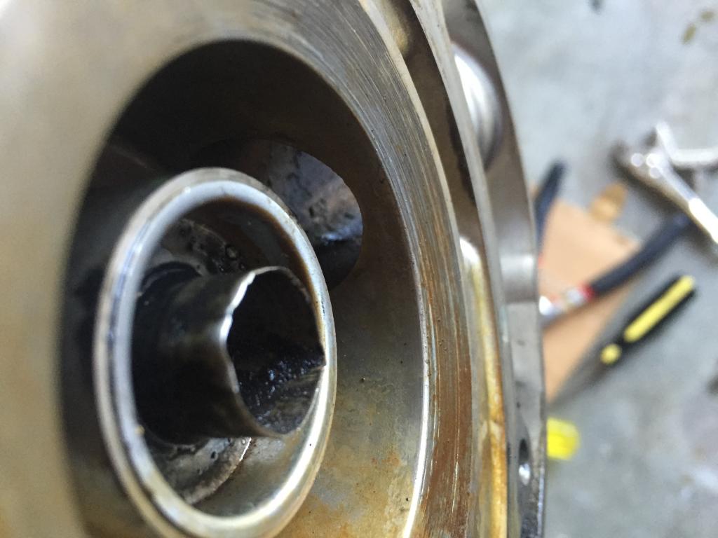

	so i started disassembly and behold "shake" in the pump and suggestions or precautions on rebuild? [ATTACH=CONFIG]102164[/ATTACH][ATTACH=CONFIG]102165[/ATTACH]
	thanks again guys the parts should come in today, and ill get to it after class tonight i keep reading that the gasket is a pain to get in any suggestions? im thinking of just taking it to a shop and letting them press it in. also bike has not ran since last week so all the " shake " should have floated to the top of overflow tank and radiator right? turkey bast it out? tampon?
	thank you for the information so should i rule out a water pump issue? how does one test for this gasket in the crankcase?

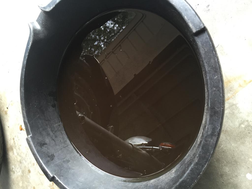

	its the pic of oil in a drip pan, ill attach again the thermostat is right under the gas tank by the fork tube just slide the tank back and its accessible

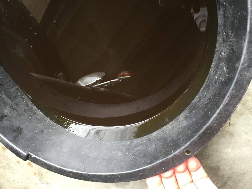

	thank you guys i took pictures of the oil does it look ok to you? i ordered water pump gasket seals o rings and thermostat as well.

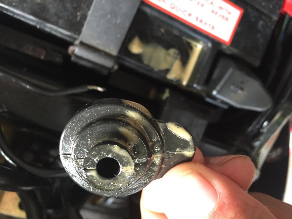

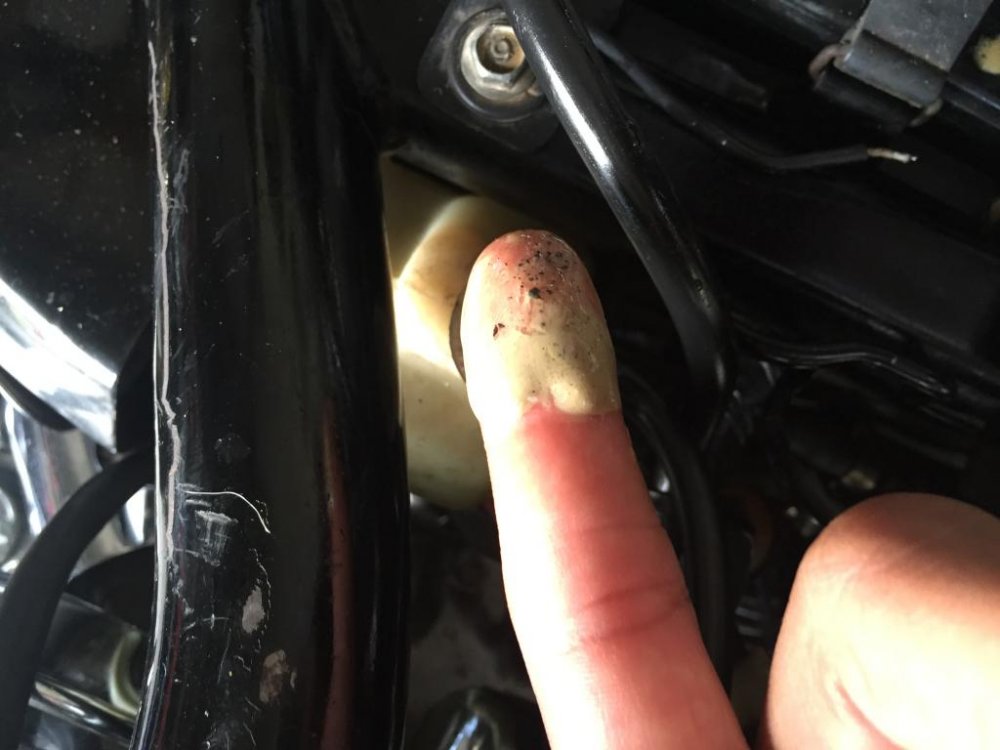

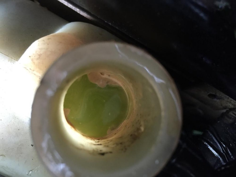

	ok so new to me bike 97 royal star ran fine during test ride no problems get it off the trailer and here we go clutch master cylinder goes out on me on my way to school make it back home somehow coolant spewing from under my seat soooooo here are the pics doesnt look like the oil so im ruling out head gasket correct? but look at my finger and the coolant tank and cap ..... is it the water pump? do replace the whole pump or just the seal? who will be the winner? thank you in advance for your help .
