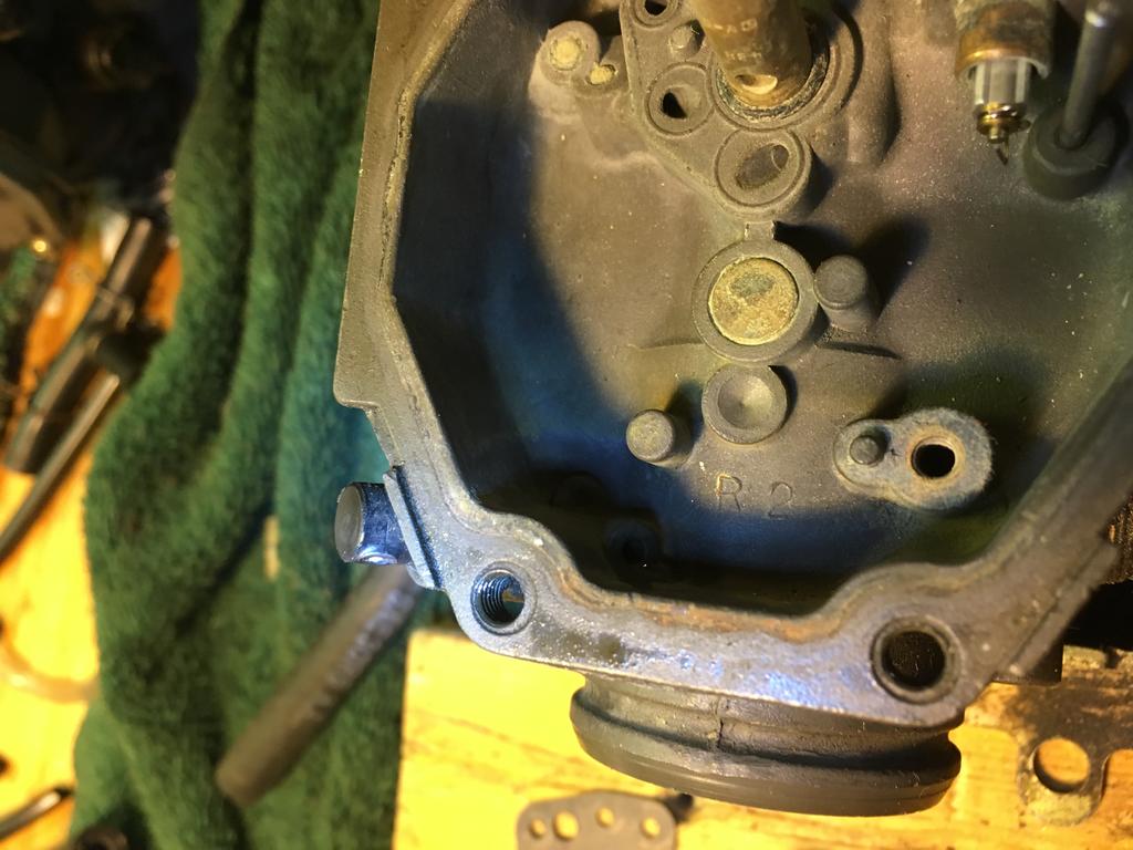

I had not thought about taking it out that way... now... how to get that darned plug out of there. I am guessing that using a self taping screw will damage it. I have a new seat and filter and am not worries about hurting the one in there now... maybe I do just shove it out of there... -
Making some progress with this set of carbs although have not found that one of them is barely flowing fuel... am thinking that the little screen attached to the needle seat is clogged. Problem: how do I get the seat out of there - it appears to be jammed in there pretty good. Am I missing an obvious set screw??? I am afraid of pulling too hard and bending the little metal shaft which holds up the float. Help and guidance is appreciated.
