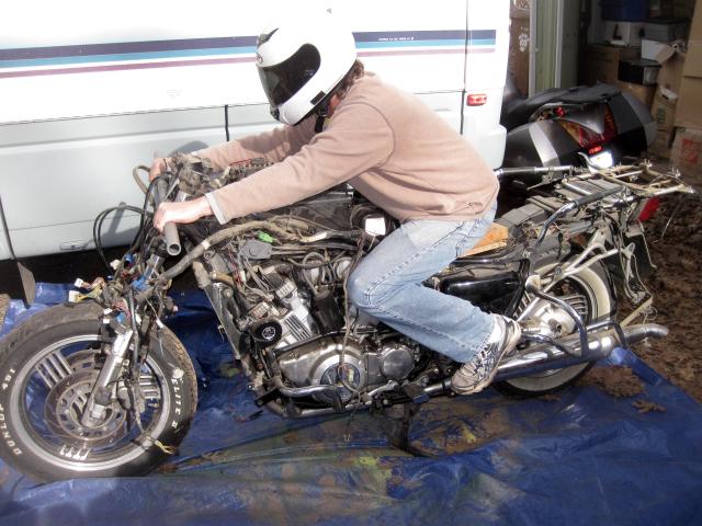

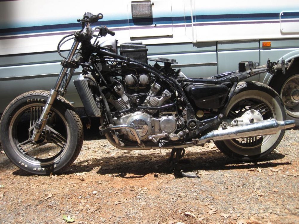

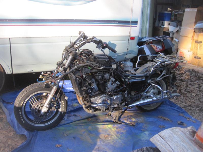

I've never seen an apocacycle in person either but I've seen pictures and can grasp the gist. Progress so far: And spare parts: The tip-over sensor messed me up for a minute until I discovered that, like the clutch lock-out switch, I can simply unplug it and throw it away. The only thing I removed that caused a not-run condition was some Hazard Lighting Module; plugged that back in and all's well. How much wire is on this thing anyway? Removing the now-dead wires and then rerouting the 'good' wires is the next, tedious step. Anyway, pretty happy with the progress so far (it still runs). -

Syscrushr - I was going to send you the tires as I know from experience how tires wear from round to rectangular when riding the endless straights in the middle of the country but I see from your map you get to the twisty parts so instead I am sending the rear chrome/plastic piece, the RH mirror, and the front fender. Enjoy. Flyinfool - I am building an apocacycle (yeah, that's a word). Here is the foundation: -

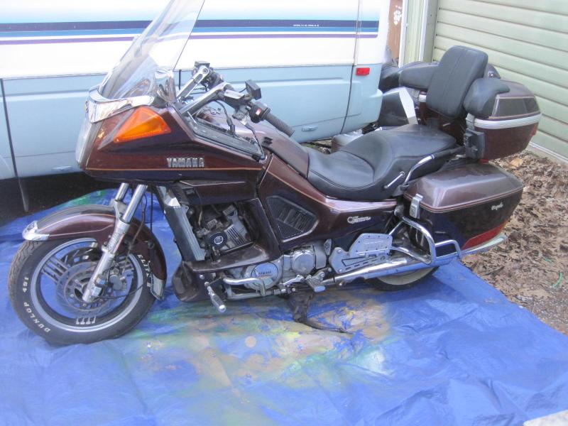

I picked up an '89 today and, thanks to the information found on these boards, got it running (first time in four years, I'm told). I have a broken clutch switch. With the wires shorted, it fired right up. I rode it around the block with no ill effects so obviously I don't need a clutch switch to make the bike run. My question is: What else can I ditch, bypass, or remove and have the bike still run? For instance, when I remove the gauge cluster, will there be some mysterious safety lock-out system that will shut me down? My goal is to get down to the absolute bare essentials and still be able to ride the thing. Wait, two questions. Is there anything on this bike that has any value or can components go straight into the recycle bin? Thanks, Brett
