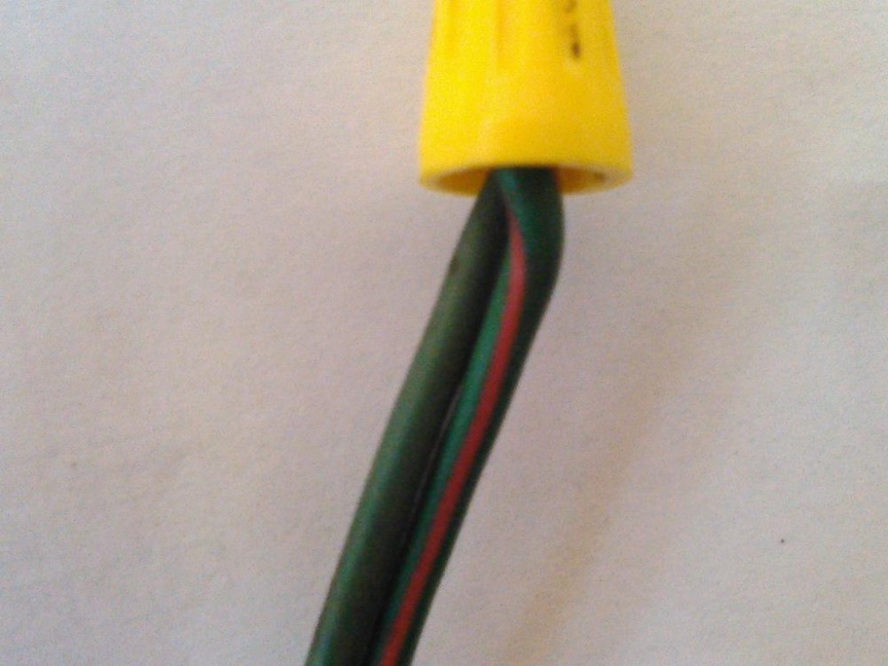

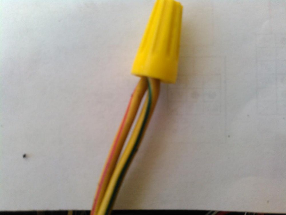

is there a way to bypass the sensors so the CMS does not see that the sensors are not there? for the brake lights? like the sensor mod for the battery which i have done successfully? also trying to find and maybe mod the oil level sensor? any help people? also found wires disconnected from CMS i believe???? yel/red to yel/green.......green/green/red is this an attempt to remove reserve lighting unit? my headlights and hi/lo switch and indicator do work Thanks Wil
