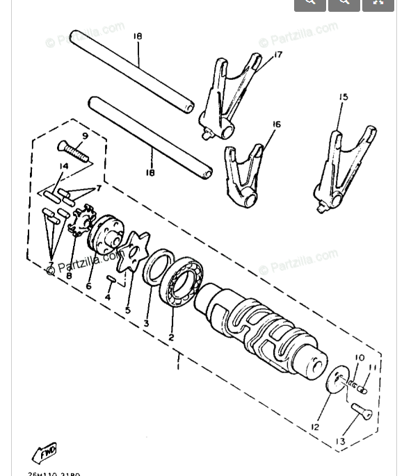

Hello-- Dropped my bike today and the shift pin for 4th / 5th gear fell out. I wouldnt be making this thread if all the pictures on this thread werent gone 😕 Which pin do I need to order if I cannot find mine? I'd like to have it in hand before opening up my motor. Also, are there any tricks to holding the clutch basket without a special tool?

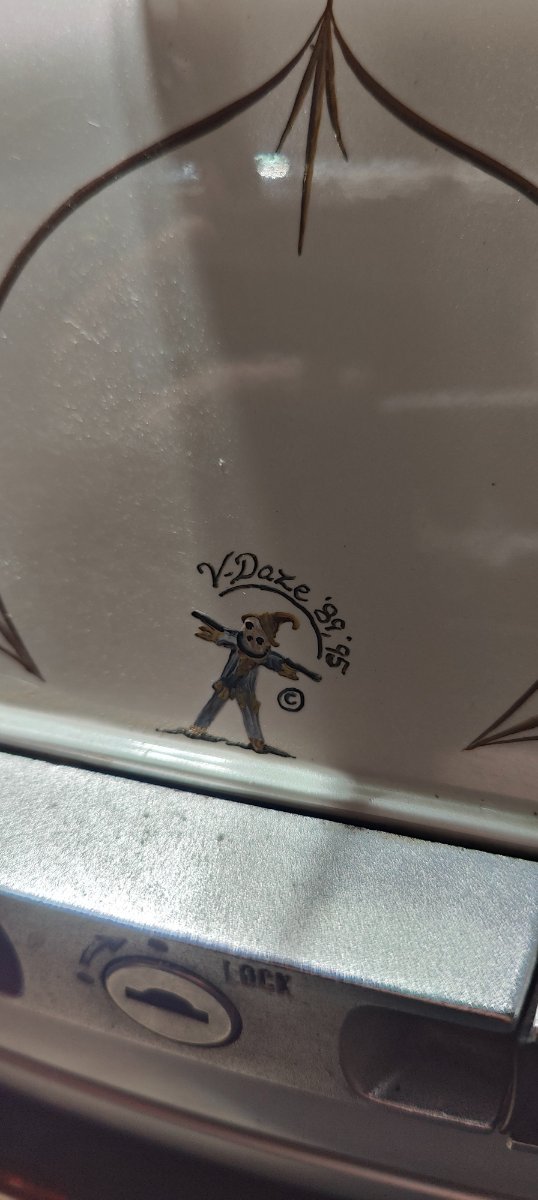

Hello-- First question, what was v-daze? I assume it was a bike show that was mainly aimed at the venture bikes? I was reading up on the tugs intake system, when I saw someone mention v-daze. I own an '88 1300, and it was hand pinstriped by who someone in the pinstripe community thinks is called scarecrow, at one of the v-daze events. I didnt make the connection until I saw mention of it here. Does anyone have any film scans of the v-daze shows from either 89 or 95? The log book I got with the bike has a mention of getting an award at "the show", and I think itd be cool to see of pic of the bike from way back in the day.
