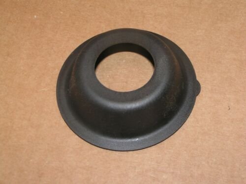

Needs complete carburetor diaphragm assemblies (diaphragm and slides) -
'86 Royale shorted battery
Terry NB replied to Terry NB's topic in Venture and Venture Royale Tech Talk ('83 - '93)
Same size for 650cc and 1300cc? -
I was straight up with the Dealer...he is saying that the carb diaphragms need replacing. His price $250.00 each. I went online and see that there are some much cheaper.....but some from China, not sure if they are of equal quality. Not Sure what I am looking for as I have never taken the carb apart. Would it be the long or short one Maybe someone knows where I can get ahold of these here in Canada or the USA. -
