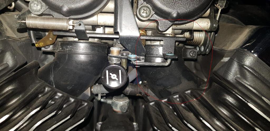

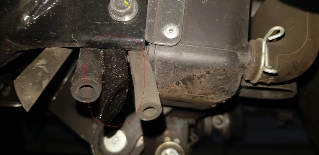

  1. Hi Experts, Looking at the carb of my 2013 RSV with 9k miles, I could see some oil seepage on the left side carb and also on one of the 4 hoses under the bike(not sure if this is the carb drain hose). Pics attached. What could be the reason for this? I have discussion on another issue in a separate thread and didnt wanted to post this there as I was not sure if they were inter related. Here is the other link https://www.venturerider.org/forum/showthread.php?142963-Gas-getting-mixed-into-Oil-Carb-rebuild Thanks for your time and apprecite your inputs. Here are the pics. [ATTACH=CONFIG]117691[/ATTACH][ATTACH=CONFIG]117692[/ATTACH]
  2. First of all, thanks for taking your time to pen down all these details. One thing I have noticed is that after every ride, when I park the bike back in the garage, I smell of gas. If this could make you think of anything else, yes. I want to try out every possible thing before I tear apart the carbs. I have no prior experience working on the bike carbs but I can follow instructions and I have a good set of tools. I used to do the work on my truck and thats the kind of experience I have. Now about the history of ethanol fuel in the bike, I am not sure. I am the third owner and the first owner did some 6.5k miles and the second owner did some 1.5k miles (in close to 1yr). So I guess with the second owner its been sitting for quite some time and not used much. This could have caused the issue that I am seeing. The bike was 450miles away from home and when I got the bike, I did see that the oil indicator was showing full on the glass. The owner said he changed the oil soon after he got it and he didnt ride much. I rode it back home 450miles with out any issue and I did another 500 miles before I changed the oil this weekend.
  3. Thanks for the suggestion. I will definitely try this out first before I tear apart the carb.
  4. Did you meant that I do not have to rebuild the carb and just the seaform will fix it?
