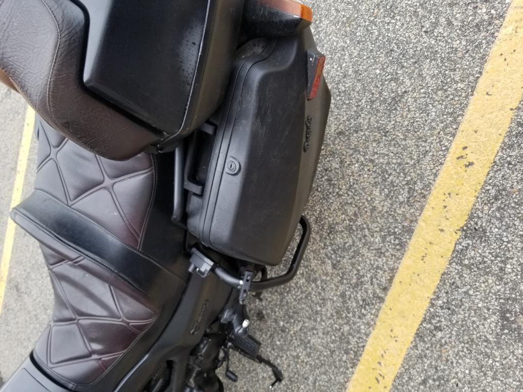

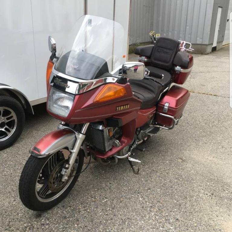

From what I've read the 86 bags won't fit mk1. It's listed as an 85 but could be an 86. Here are some pics, black bike is my 84 -
