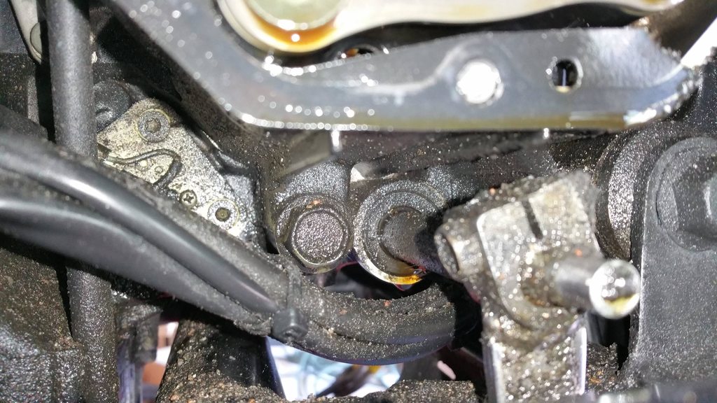

Just a quick update.. The leak is... Gone! Took it for a spin, came back.. Seal is bone-dry on the outside. So if anyone else has trouble sealing up the shift shaft, Try a 13mm ID double-lip spring seal. Mine was 7mm wide but I don't think that's crucial, that's just what the bearing house had in the catalog. peace Vlad
I picked the seal up at our local bearing house in Tulsa, OK. It appears to be available online from a few vendors -- SKF part# 563793. Just went out in the garage and took a peek.. Not a drop under the bike or around the seal, so it's definitely an improvement, as with the other seal it would weep even without the engine running. Will post an update once I put a few miles on it. peace Vlad
Well, I decided to go with a undersize seal. Stock calls for 26mm OD, 6mm width and 14mm ID. I went with a 26x7x13 (7mm width and 13mm ID) so it would snug up against the shift shaft a little better. So far, it looks promising. No leaks while sitting with engine off and full of oil (the stock replacement seal leaked right away).. I'll take the bike for a spin some time over the next couple of days, once the rain clears... Fingers crossed.. I'd like to get on with the project and fix the clunky U-joint, and get this bike out of my garage peace Vlad
Well, dang. I replaced the seal, but no dice. Still leaks like a sieve in the same spot, even without the engine running. There's a tiny bit of play in the shift shaft even with the outer end riding inside the middle gear cover, like it's supposed to be.. However, it leaks even when not applying any sideways force to the shift shaft. I ordered the correct seal from PartZilla.. I did notice that there's a slight witness ring on the shift shaft right where the seal lip would ride. Is it possible that the shaft itself is worn to the point where the seal will not work? Any suggestions welcome..... Keep in mind this bike has 120K+ miles on it.. Vlad

On this bike, the shift shaft sticks out quite a bit from the transmission case itself. It does not go through a sidecover at all, although I did have to pull the middle gear cover just to be able to access it. It seems like an odd design choice, but it is what it is.. LOL edit: see my post below. I'm a dummy. This definitely cannot be machined in place.. But if there's no replaceable bushing behind that seal, I might still be able to use a sleeve of some sort. Hopefully someone else will chime in with a (hopefully) simple solution Vlad
Hey folks. I'm helping a friend out with his high mileage '03 Venture and its several oil leaks. The bike has over 120K on the odometer. The rear valve cover gasket was toast, which wasn't too big of a deal to replace. But now I noticed that the shift shaft seal is leaking pretty bad, and the bearing (or is it a bushing?) for the shift shaft is also wore out, and the shift shaft has quite a bit of sideways play. It looks like the seal is easy enough to replace.. But what about the bearing? Can it be done with the engine still in the frame? Thanks! Vlad
