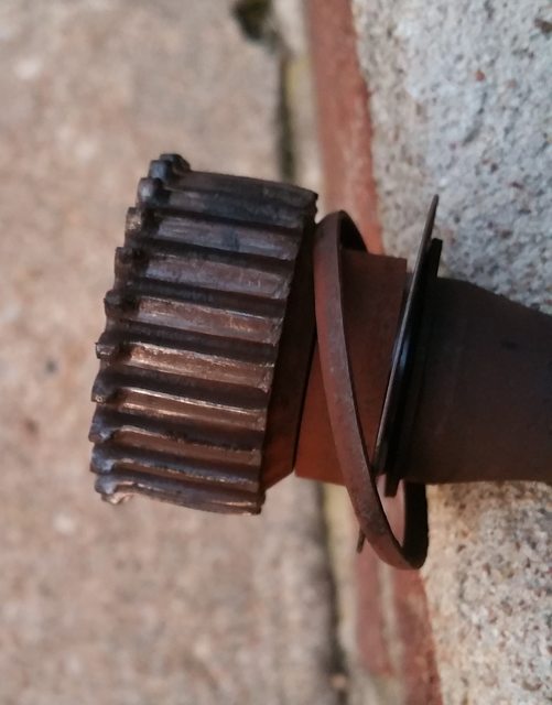

Some more pics of the carnage... Looks pretty dry. Don't think it's ever been serviced. There's a bit of grease on the forward end of the driveshaft, and the hub side of the final.. Splines on the hub don't look bad. These, however, are toast. There's no sign of anything rubber in there, either. Wonder what happened to it? Peace Vlad http://imgur.com/HkxA9Vyl.jpg http://imgur.com/YqnSoF8l.jpg http://imgur.com/vboxADFl.jpg
Hey folks. So I'm still having some issues with this high mileage '03 RSV. Got the oil leaks under control, it seems, but now I got the call from the owner as he was loading the poor thing on the trailer on the side of the road. It seems something in the final drive gave up the ghost. It shifts into gear just fine, and at first, feels like it's gonna pull ok, but then all power to the rear wheel goes away and gears start grinding.. I'm pretty sure it's coming from the final and (crossing fingers) not the middle gear. U-joint appears OK, from what I can see past the dust boot. I'm ready to order another used final assembly off ebay, but wanted to hear if anyone had similar symptoms. The bike is not in my garage so I can't easily take a look at it right now, but I'll probably go load it up and haul it back tonight. Are these finals prone to issues? Granted, this one has 122K on it. Also, what years are compatible? According to part numbers, it seems '99 and up is the same.. Is this correct? Thanks! Vlad
