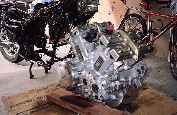

The right lower side rail was then removed and with a wheeled
floor jack supporting the engine and the help of a couple of friends we
managed to wrestle the engine out. A couple of points. The shift
mechanism had to be disconnected to enable the clutch slave cylinder to
come free. It would have been easier to disconnect the hydralic line
and remove the slave cylinder with the engine. Also we tried to turn
the engine out of the frame. We ended up removing the rear brake master
cylinder and reservoir as well as the rear cylinder valve cover to get
enough clearance to lift the rear mounting bolts clear of their frame
slots. Once clear of the frame we carefully lifted the engine onto a
wheeled cabinet.

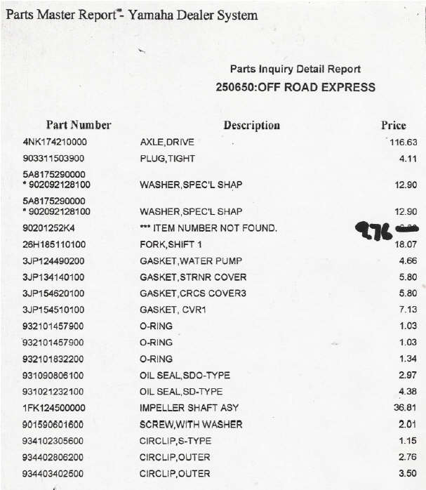

I ordered a 2nd/5th gear kit which included two pinion gears and two
wheel gears. These were substantially different than the originals and
I'm told that these are updates that have been made over the years on
the Venture and V-Max models. They did provide a lot more gear overlap
for both 2nd and 5th and looked sturdier and wider. They fit perfectly.
I also replaced the Drive Axle, thrust washers, as well as the 2nd gear
shift fork. If your 2nd gear has worn to the point where it isn't there
at all, you will likely need the shift cam and shift fork shaft as
well. I also replaced just about every gasket and oil seal I could
find. (A complete parts list is posted on the last page.) As a side
note, virtually all of these parts have been upgraded or superceded
several times over the years. The Drive Axle for example is the fifth
version of this and there are several subtle differences in the oil
paths but it does fit perfectly.

Part 5
Re-Installing the Engine
| Ready for
install - Left View |
| Ready for
install - Right View |
I'm doing a few things differently from when I pulled the
motor out. In an effort to gain as much clearance as possible and
simplify the task I've left a few things off and put others on. In the
left view of the motor, the clutch slave cylinder is mounted to the
engine and the shift shaft linkage is connected. This will be two less
things to fiddle with when remounting the engine. The downside, and
it's minor, is that I will have to reconnect and bleed the clutch line.
In the right view, notice that the water pump, thermostat
assembly and starter motor are not in place. This provides some much
needed clearance on the front end. Further, the drive shaft is still
not in place so all I have to worry about there is getting the yoke
into the swing arm and I don't have to worry about mating the splines
at this point.
The rear brake master cylinder is also not in place. I had to
remove it to get the engine out and since I plan to upgrade the brake
lines anyway, bleeding the brakes will have to be done regardless.
The lower right frame rail will also come off to provide room.
I had it re-mounted to the to keep the parts together. One last point
prior the task is to have the rear exhaust header handy. It has to go
in with the motor. You can't put it in after the fact.

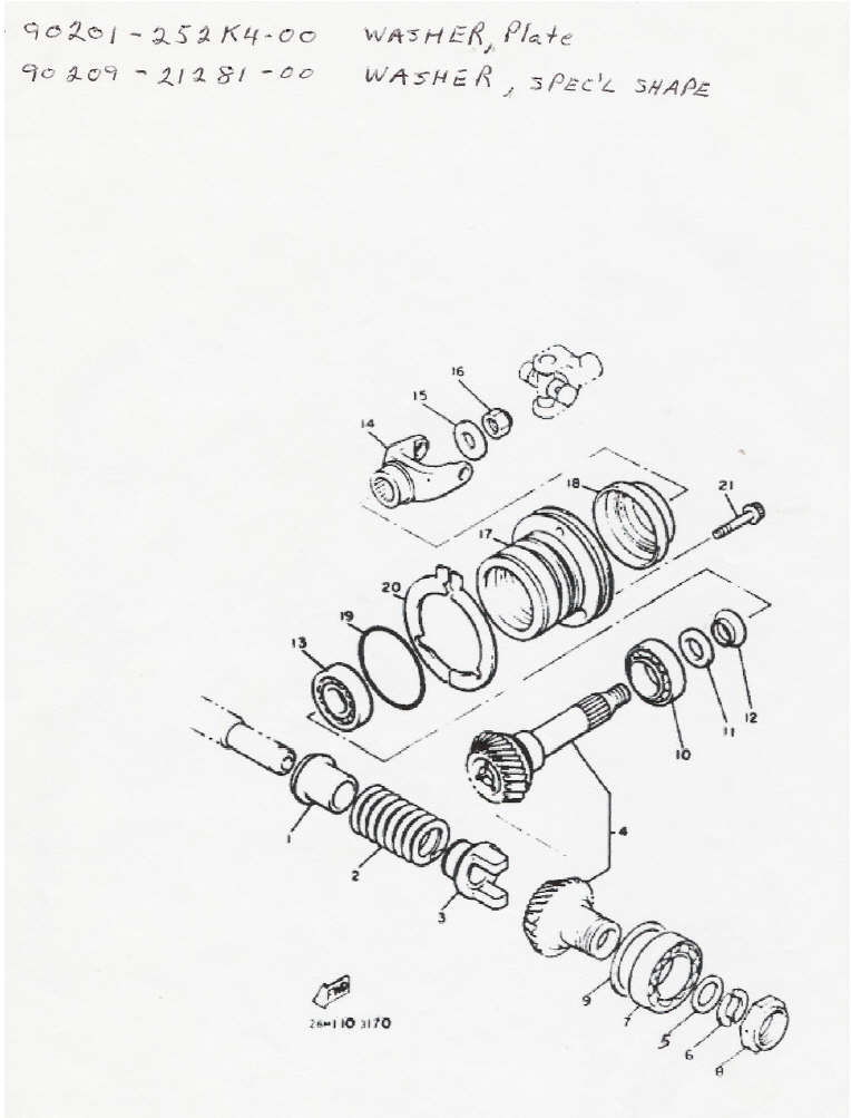

The first list contains the parts that I found were specific
to the 2nd gear repair. As my 84VR had only just started skipping, this
should be considered a minimum. I have included gaskets and seals that
can only be accessed with the crankcase split. I believe that they
should be considered essential changes as part of this repair.
| PART
NUMBER |
DESCRIPTION |
PRICE |
| 99999-01573-00 |
2nd/5th
Gear Kit - Includes:
1FK-17121-01 Gear 2nd Pinion
1FK-17151-01 Gear 5th Pinion
1FK-17221-01 Gear 2nd Wheel
1FK-17252-01 Gear 5th Wheel |
$298.25 |
| 4NK-17421-00 |
Axle
Driven |
$206.44 |
| 90331-15039 |
Plug
- Axle |
$4.69 |
| 5A8-17529-00 |
Washer
Thrust (2 required) |
$7.47 |
| 90201-252K4 |
Washer
Plate (170-16154-02) |
$11.66 |
| 26H-18511-01 |
Fork
(Shift #1) |
$25.58 |
| 3JP-12449-02 |
Gasket,
Water Pump (26H-13410-44) |
$8.91 |
| 3JP-13414-01 |
Gasket,
Strainer Cover (26H-13414-00) |
$11.89 |
| 3JP-15462-01 |
Gasket,
Crankcase Right (26H-15462-00) |
$10.36 |
| 3JP-15451-01 |
Gasket,
Crankcase Left (26H-15451-00) |
$11.97 |
| 93210-14579 |
O-Ring,
Oil Pump Pipe (2 required) |
$1.87 |
| 93210-29196 |
O-Ring
(371), Neutral/Gear Indicator Assembly |
$2.92 |
| 93210-18322 |
O-Ring
(1L9), Clutch Push-Rod Bushing |
$2.20 |
| 93109-08061 |
Oil
Seal (12E), Clutch Push-Rod (371-15389-00) |
$3.24 |
| 93102-12321 |
Oil
Seal (30X), Shift Shaft (93102-12106) |
$7.51 |
| 90215-25218 |
Washer,
Lock, Clutch Basket |
$2.42 |
| TOTAL |
$617.38 |

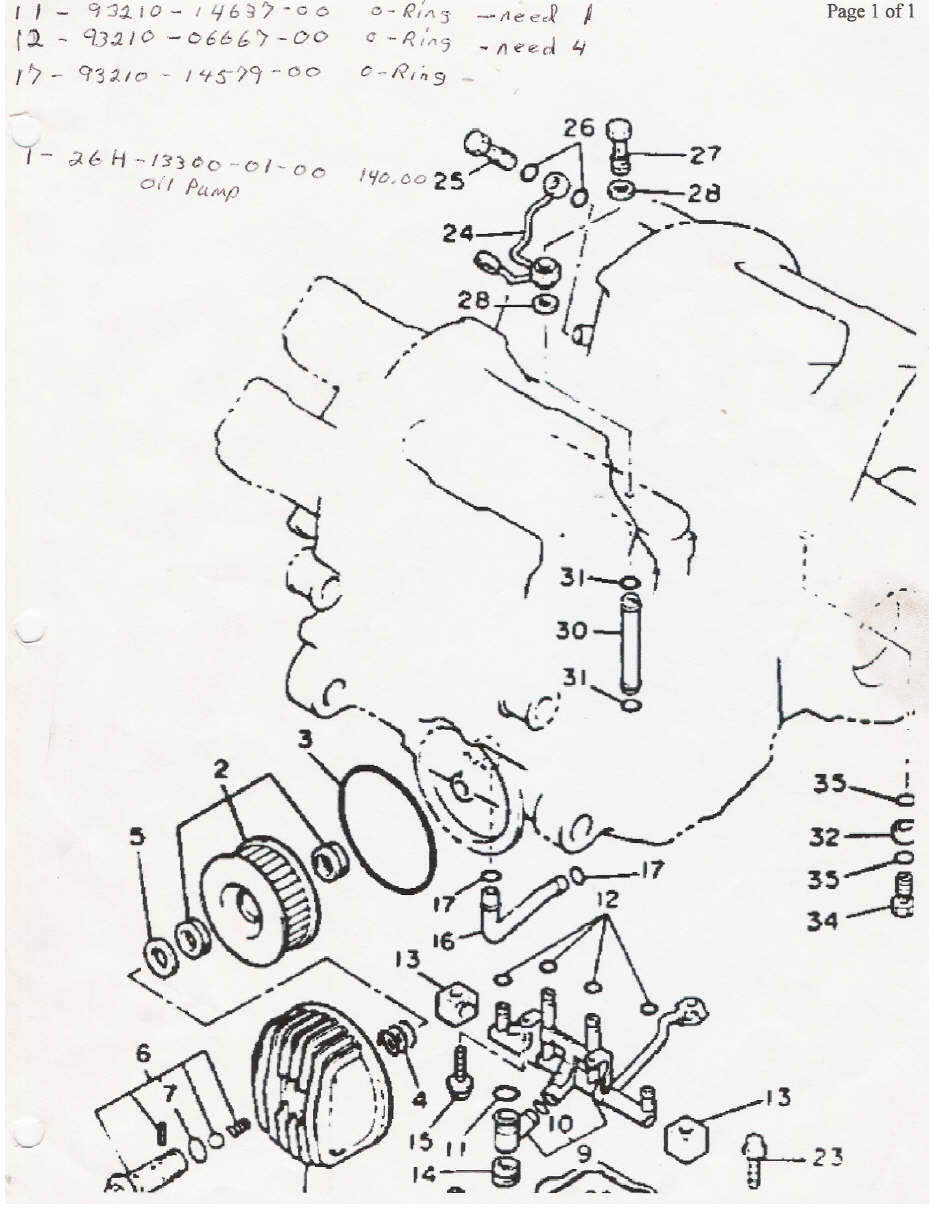

The last table lists the other parts that were purchased for
general winter maintenance. This includes a brake overhaul, cooling
system overhaul and general tune-up items. This list sort of grew with
the project and kind of got out of hand. However, it all goes towards
maintaining a sound reliable bike.
| PART
NUMBER |
DESCRIPTION |
PRICE |
| 26H-11193-00 |
Valve
Cover Gaskets (2 Required) |
$48.99 |
| 47G-11166-00 |
Pipe,
Breather 1 (Crankcase Ventilation) |
$9.38 |
| 93211-16591 |
O-Ring,
Water Pump Cover |
$4.41 |
| 93210-27778 |
O-Ring,
Water Pump Cover (93210-14104) |
$0.93 |
| 93210-27778 |
O-Ring
(1KT), Coolant Pipe to Thermostat (2 Required) |
$9.13 |
| 1J7-13441-10 |
Element,
Oil Filter |
$9.18 |
26H-12169-10
26H-12168-Y0 |
Pad,
Adjusting 2.70
Pad, Adjusting 2.65 |
$15.28 |
| 246-FA88HH |
EBC,
Double-H, Sintered ST Brake Pads (3 sets) |
$169.25 |
| 91316-10020-00 |
Frame
Bolt |
$2.85 |
| 1FK-24560-00 |
Fuel
Filter |
$14.49 |
| 26H-12576-01 |
Coolant
Hose #1 |
$18.70 |
Galfer
Clearcoat Stainless Steel Brake Line Set (5 hoses) |
$372.26 |
| 350-DPR8EA9 |
NGK
Spark Plugs (4 Required) |
$24.58 |
| TOTAL |
$699.43 |
