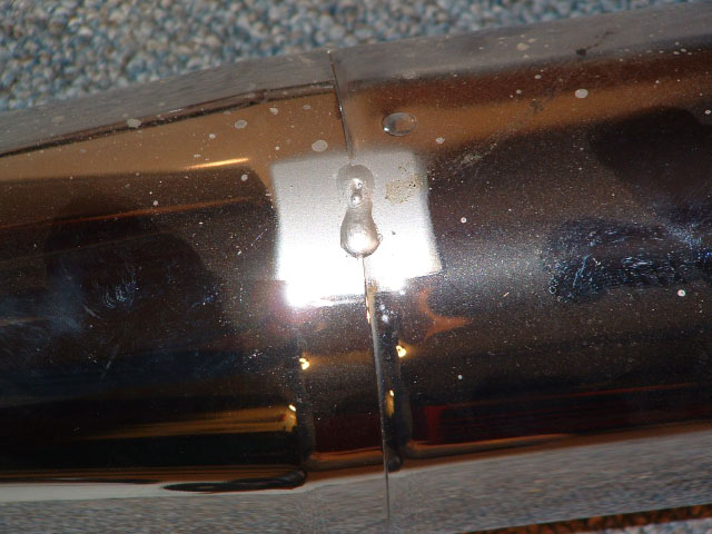

After removal of the stock muffler I took my Dremel tool and cut the three
rivets holding the stock heat shield to the Venture pipe.

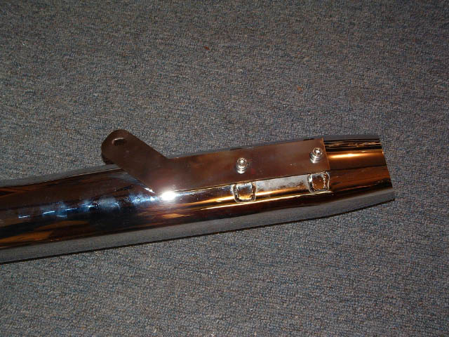

Looking at the heat shield next to the RK pipe in the following picture you
can see the square opening for the muffler clamp, just below this square
opening cut the heat shield in the center, DO NOT cut the top section above
the opening, just the bottom section, this will allow the heat shield to
expand around the RK pipes. Next drill three 1/8 inch holes in the heat
shield, I drilled them near the spot welds. Now put the HD muffler clamps over
the muffler end and position the heat shield so that opening is to the inside,
hint, the factory dimple in the HD classic pipes goes to the inside, I
aligned my opening on the same side as the dimple in the pipes with a slightly
downward angle so that I could easily get to the muffler clamp once the
muffler is on the bike. Be sure and put the HD clamp on BEFORE putting
the heat shield on the RK pipe. Now drill through one of the 1/8 inch holes in
the shield and into the RK pipe and put ONE rivet in.

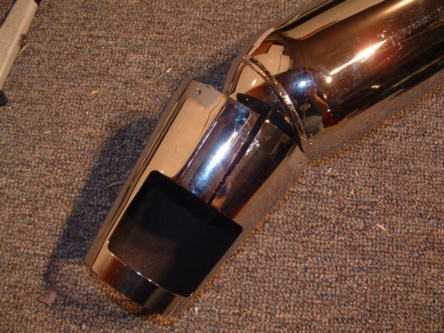

I then used a standard drill with a bit extension and then drilled out the RK
mufflers after installation from the rear of the bike. I used a magnet to
retrieve any metal filings left. inside the muffler.

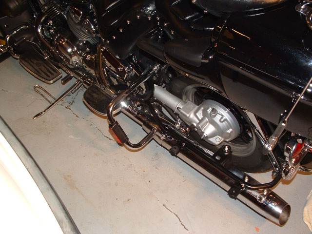

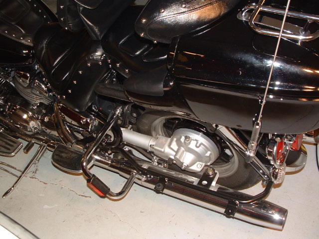

RK's installed, you can see the rear mount attached to the RK pipe.

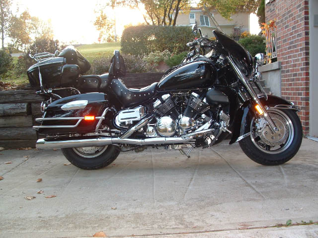

Finished product.
Hope this helps anyone interested in doing this modification, I love the sound
that I achieved with the Road King pipes.
