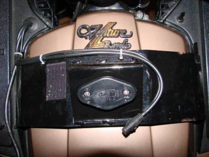

Here is the top bracket mounted to the side brackets, on top of the battery cover.
The top mount bracket follows the contour of the battery cover with about ½” clearance.   The top bracket has a bit of flex in it so that the GPS bounces slightly over big bumps, isolating the hard drive based unit from severe pot holes and vibration.

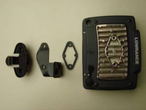

Rather than using the Lowrance provided motorcycle mount which mates with the clip on the unit, I bought a RAM RAP-326MU “Ezy-Mount Quick Release Male Plate on Raised Diamond Base” that mates with the existing clip on the GPS.  To position the GPS at an appropriate viewing angle, the clip is mounted on a wedge.
The RAM clip works OK, but I was a bit worried about it failing, causing who knows what calamity while riding, or the unit being easily stolen when left unattended.  To fix this, I came up with a simple steel bracket that mounts to the GPS, between the heat sink and the RAM female clip.  This bracket is bent to mate against the wedge bracket.  A simple padlock secures the GPS to the bike mount bracket.  I put 3/8”grommets in both the GPS bracket, and the bike mount bracket for the padlock loop to go through, and Velcro between the padlock and the bike mount bracket to keep the padlock from vibrating and disturbing the music.

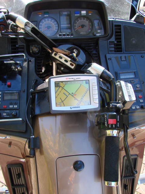

With the GPS mounted in it’s bracket, the handlebars clear the unit at both right and left lock.

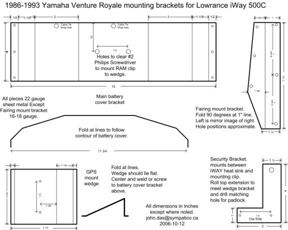

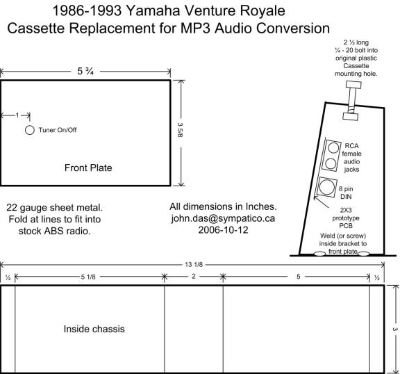

Here are some diagrams with dimensions of the main bracket parts.  I didn’t have access to a shear or brake to cut and form the pieces.  I used my table saw with an abrasive cut off blade to cut up an old computer case for the bracket pieces, and used my MIG welder to attach the weld nuts to the fairing brackets, and the wedge to the battery cover bracket.  Simple nuts and bolts would also work fine.

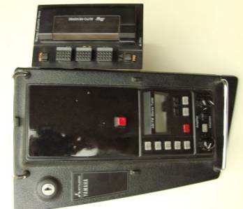

I had no desire to keep the old cassette unit it the bike.  So I removed the unit from the original radio shell, and added my own cover plate.
Normally, ejecting a cassette turns on the radio tuner, and inserting a cassette turns off the radio tuner, and turns on the cassette.  A switch is used to replace this functionality.  The red switch is used to turn on/off the radio tuner.  It isn’t integrated into the GPS, so if you want to listen to the radio, you have to turn off the MP3 music if the iWAY is turned on.  If the iWAY tells you about your next turn, it will be heard above the radio level, depending on how loud you set the iWAY audio and speech settings.

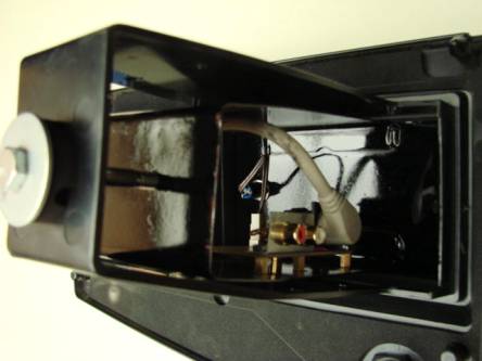

This is the inside view of where the cassette used to be.  The beige cable that used to plug into the cassette, now plugs into a female 8pin DIN connector on a small prototype circuit board.  The circuit board has a bracket for two RCA audio connectors for right/left audio, and a little PCB jack that feeds the red radio on/off switch.
Here is the design for the cassette replacement chassis.

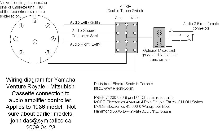

This is the electrical diagram for the connection to the Mitsubishi radio unit.
I got the 8 pin DIN PCB receptacle from Electrosonic in Toronto.   The prototype PCB and tuner ON/OFF switch and Audio Ground Loop Isolation transformer came from Radio Shack.

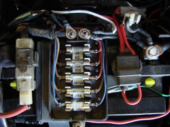

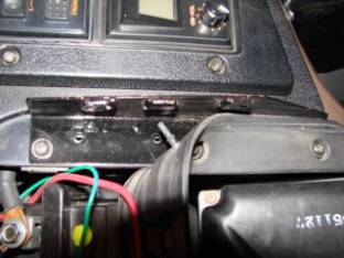

It’s fairly simple to connect the GPS to the bike’s switched accessory power connectors.  Front of the fuse panel on top of the battery.  There are two screws, left is ground, and the other is +12V.
It’s a bit of a job to feed the wires into the fairing area.  You might remove the top left fairing cover that holds the speaker and radio pieces to get clear access to the cable routing used by Yamaha.
In my prototype unit, I found that the Mitsubishi amplifier seems to pick up a lot of electronic noise from the GPS.  To reduce this to acceptable levels, I used a Radio Shack Nexxtech 2700054 ground loop isolator transformer.
