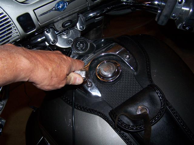

Step 1: Remove the cowling around the gas cap.
.jpg)

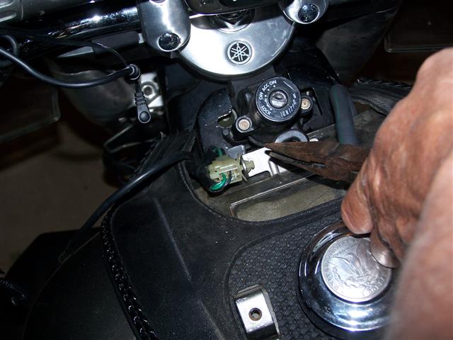

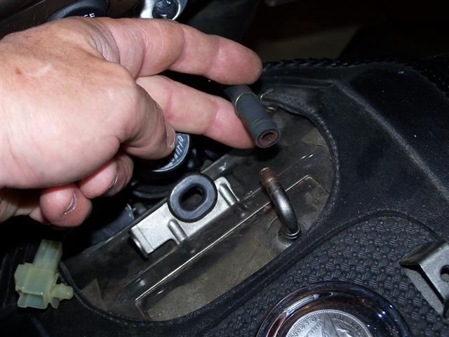

Step 2: Use a pair of pliars to squeeze the tabs to unplug connector from metal tab.
.jpg)

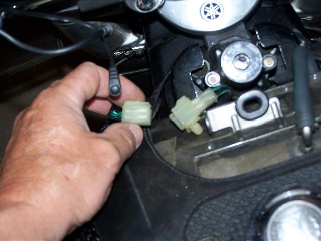

Step 3: Unplug the connector.
.jpg)

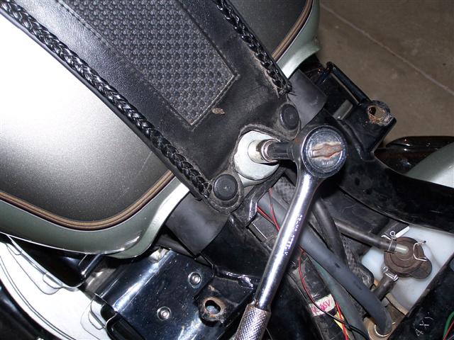

Step 5: Remove single bolt on rear tang of tank.

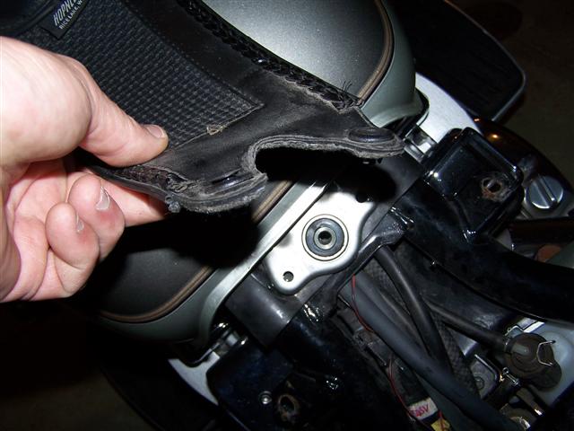

Step 6: Remove push pins that hold bib in place.
.jpg)

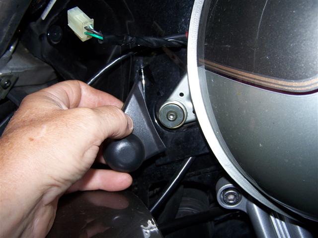

Step 7: Rubber covers just pull off front mounts. Remove covers and then allen head screws.

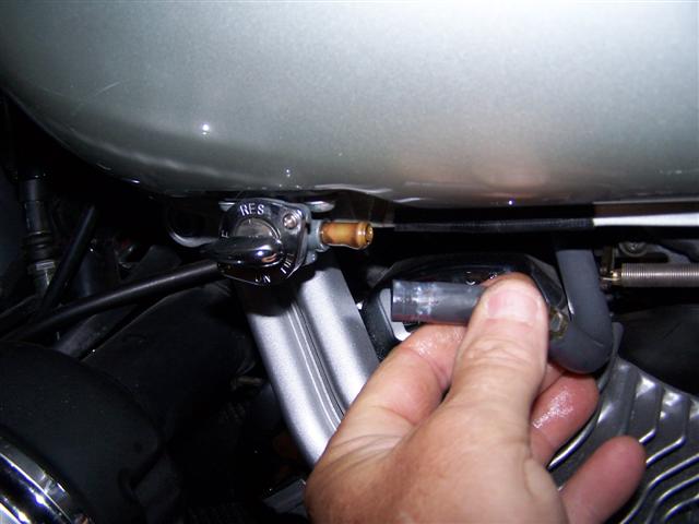

Step 8: Turn fuel petcock to "OFF" position and them remove gas line.

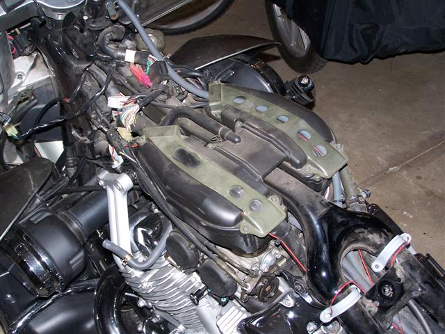

Step 9: Simply lift tank off and set it aside. You are done.
