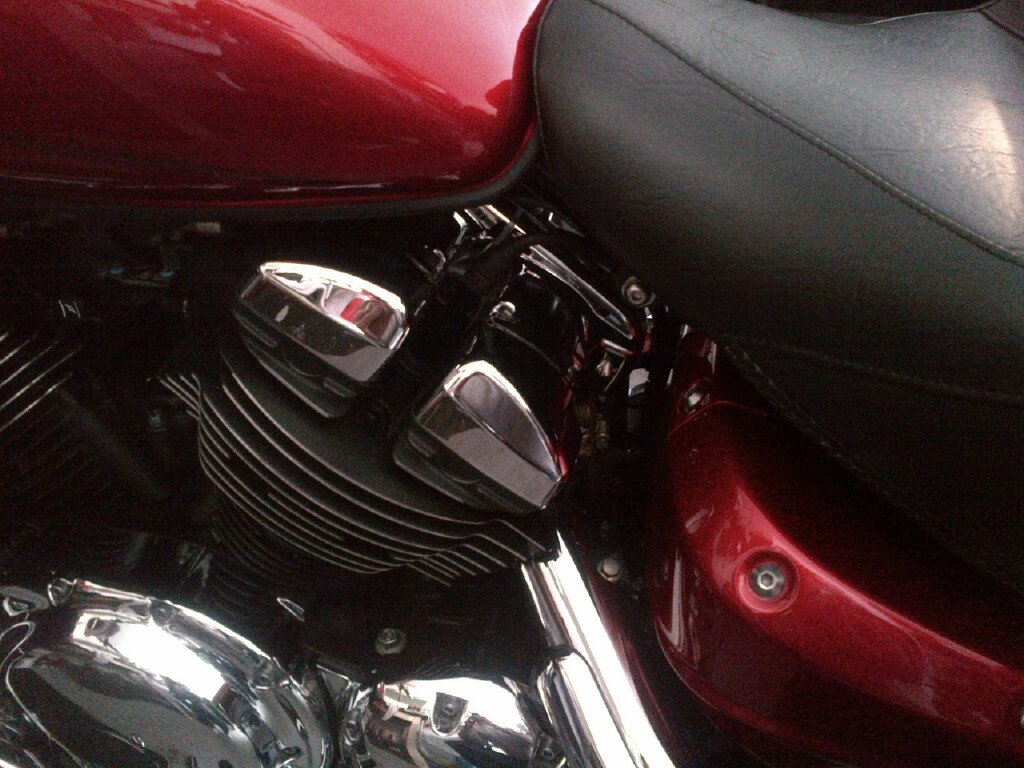

John Boat Posted October 9, 2022 Share #1 Posted October 9, 2022 Does anyone know what this bracket is for? I have looked it up and nothing. What attaches to it? May be a silly question. Link to comment Share on other sites More sharing options...

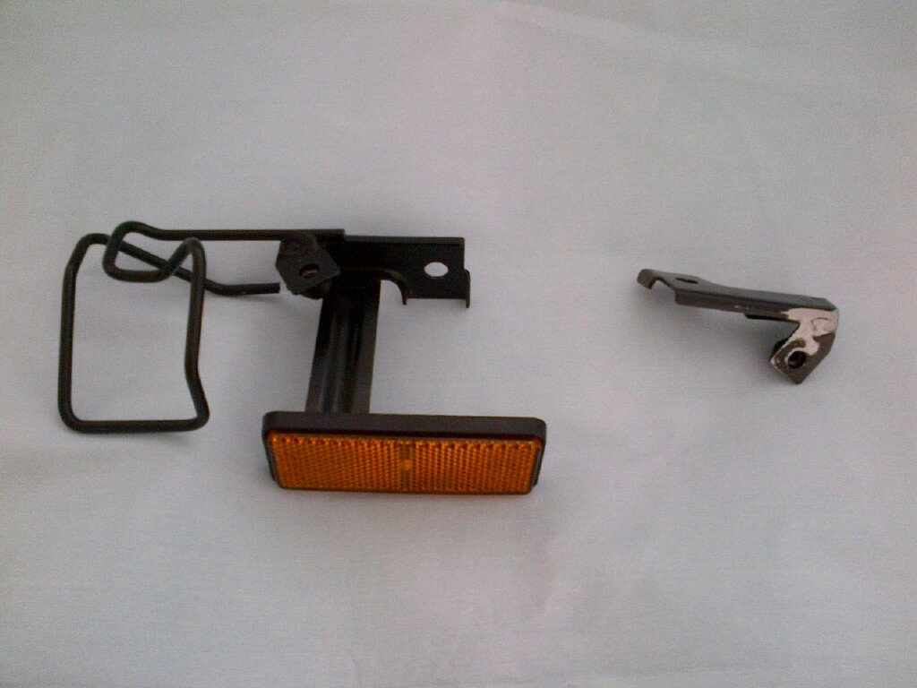

M61A1MECH Posted October 11, 2022 Share #10 Posted October 11, 2022 Many years back I asked the Yamaha reps at Bike Week in Daytona what that was for and they told it was a deflector to fuel that could get spilled, it supposed to keep the raw fuel off the hot engine parts. It is supposed to be on the left side, One of the bikes on display that year someone had put it on the right ride, when I pointed that out to them they got all red faced and took the bike off display to fix it, the next day it was back with the deflector on the correct side. I also know that the wire part of that is there to keep you from putting your leg on the valve cover, because if you wearing shorts and your leg touches that wire, you pull back before you can close to the valve cover, it gets plenty hot. 1 Link to comment Share on other sites More sharing options...
John Boat Posted October 12, 2022 Author Share #11 Posted October 12, 2022 3 hours ago, M61A1MECH said: Many years back I asked the Yamaha reps at Bike Week in Daytona what that was for and they told it was a deflector to fuel that could get spilled, it supposed to keep the raw fuel off the hot engine parts. It is supposed to be on the left side, One of the bikes on display that year someone had put it on the right ride, when I pointed that out to them they got all red faced and took the bike off display to fix it, the next day it was back with the deflector on the correct side. I also know that the wire part of that is there to keep you from putting your leg on the valve cover, because if you wearing shorts and your leg touches that wire, you pull back before you can close to the valve cover, it gets plenty hot. Yea I figured the shield out, but the wire bracket was puzzling me. I was at my local bike shop tonight and they had a beautiful pearl white 06 RSTD and it had the same brackets on it. I figured it must be a lift bracket from the factory as the engine would be hanging from a hoist of some type before it was married to the frame so it seemed practical to have a bracket that they could just leave there so why not make it look good. Just my thoughts. Link to comment Share on other sites More sharing options...
BadCatClassics Posted October 20, 2022 Share #12 Posted October 20, 2022 Took mine off years ago. Also cleaned up some other brackets, the front reflector and rear bracket under the rear fender. The fasteners are way to light to be used for engine installs. Mainly some engineering overkill as far as I can tell with shielding. 25,000 miles on mine without, no negative effects and much easier to clean up without. One fastener has to be shortened up 3mm or so to make it work for the valve cover. Link to comment Share on other sites More sharing options...
