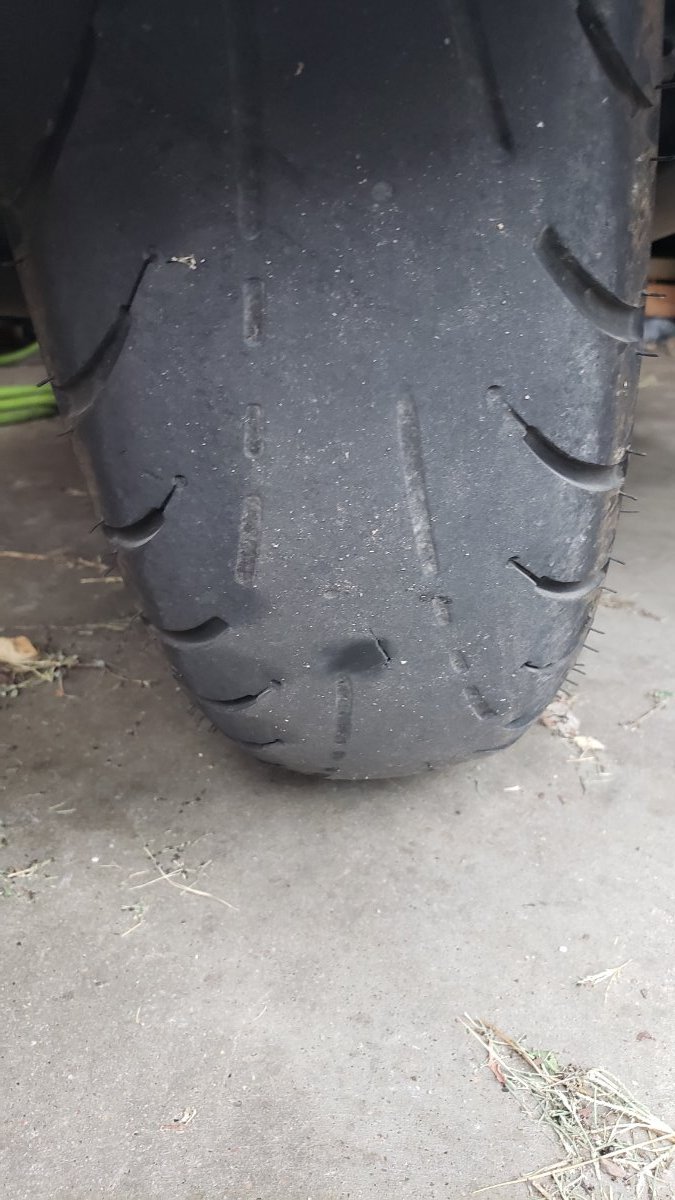

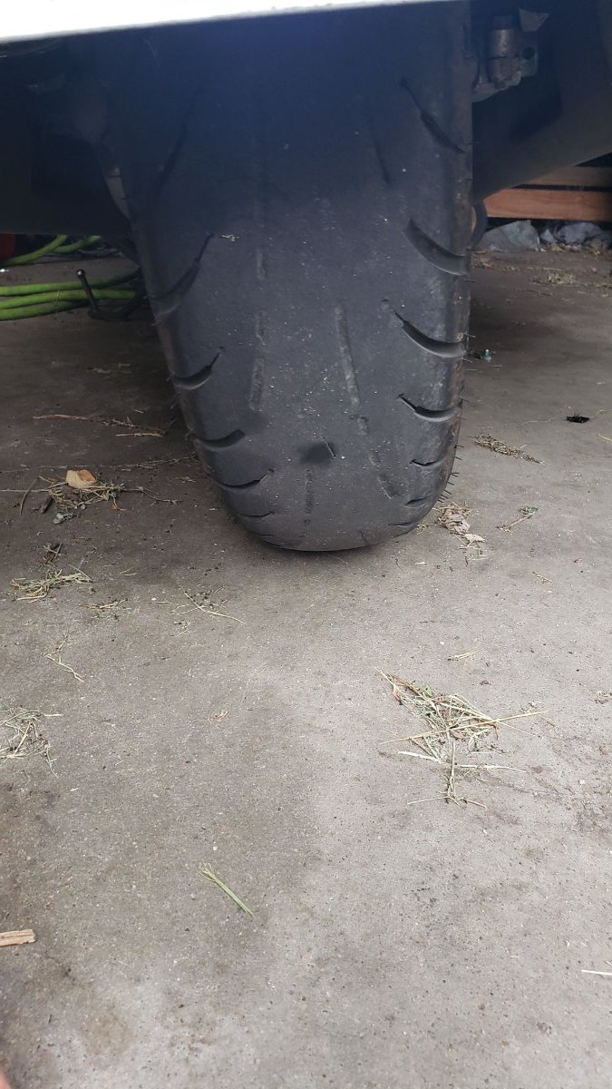

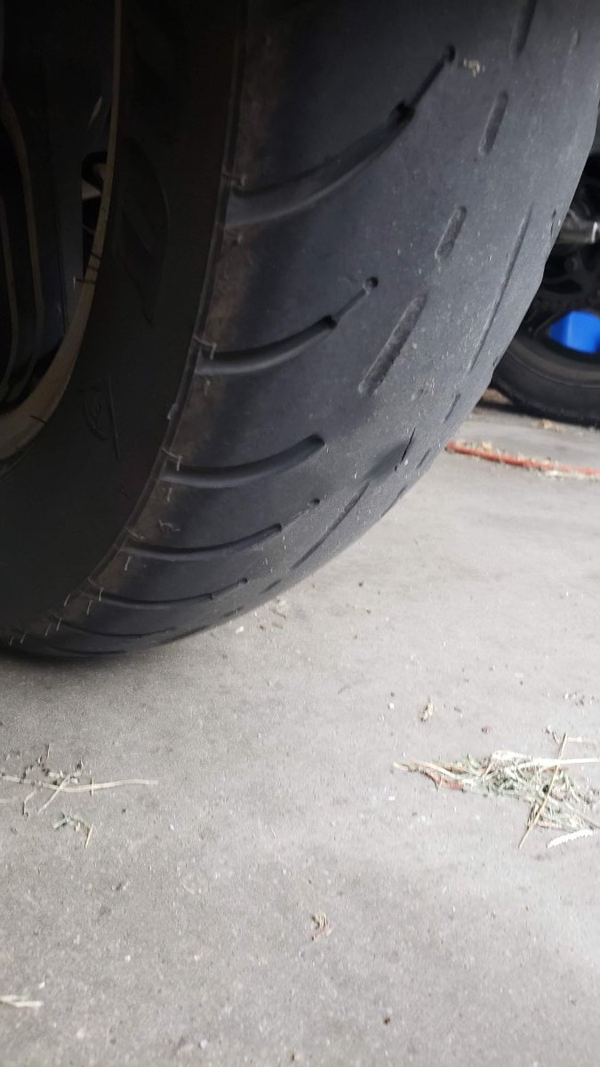

TTrax Posted July 29, 2022 Share #1 Posted July 29, 2022 OK, got my weekend project lined out since it is going to be raining and cooler. I really was hoping that I wouldn't be doing this already, but it looks like it is past time for a rear tire on this bike. I changed it out at the beginning of the riding season last year and I haven't made it through this one yet and it is quite worn. Both front and back are Elite 4's, front tire wear is minimal. I check them before every ride for tire pressure, trying to keep around 38 psi in the rear tire and around the same or as low as 36 in the front. I had switched from D404's in hopes of getting more miles out of them. It seems the D404's were getting around 6K miles and I just checked the mileage I got on the E4's and it is a shade over 7,500 miles. I see quite a few people saying they are getting over 12-14K miles out of E4 tires, so not sure why my mileage is so much worse. I am thinking I am probably overloading them. My wife and I are no featherweights, I am around 260 lbs and she is a shade under 200. We usually have the luggage loaded up on longer trips but I don't think we are carrying over 30 lbs overall. I already have the local bike shop ready to change this one out with a D404 since the mileage difference hasn't been great enough to overcome the cost difference. Wondering if others have similar mileage or maybe I'm doing something wrong.? Hope you all have a great weekend! Link to comment Share on other sites More sharing options...
vzuden Posted July 30, 2022 Share #2 Posted July 30, 2022 The load your tires are carrying is a factor but another consideration is the condition of the roads. Many don’t realize it but every little bump or even expansion joint causes a tire to lose, very briefly, contact with the road surface. When contacting again it grinds a little more rubber off. Now add your load and maybe higher temperatures and it exaggerates it a little more. 1 Link to comment Share on other sites More sharing options...
Freebird Posted July 30, 2022 Share #3 Posted July 30, 2022 Also the type of roads in your area. Chip Seal type roads are notorious for wearing out tires. 2 Link to comment Share on other sites More sharing options...
TTrax Posted July 31, 2022 Author Share #4 Posted July 31, 2022 Very well could be it. They love chip and seal around here. I was thinking I would at least get twice the mileage out of the E4 tires but it was worth trying to see what would happen. Will probably just run with the 404's from now on. Thanks and have a good day everyone! Link to comment Share on other sites More sharing options...

Marcarl Posted August 5, 2022 Share #9 Posted August 5, 2022 With the load you are putting on I would go to 40 lbs. 38 might be creating too much heat. 1 Link to comment Share on other sites More sharing options...
