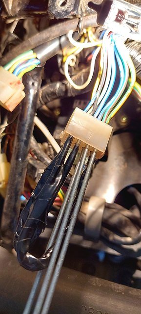

Appreciated all the responses. Once again the brothers came thru!
Ok, I thought the bypass recommended would be a quicker test to eliminate the RLU which luck has it appears to be defective. Bypassed with jumpers as suggested in VerntureVet's link below. Upper/lower beams fully functional. Display 'light' indicator on CPU stays on after self check. Below is my rendition of a bypass mess, but it worked. Fortunately I have a spare 87' parts bike to salvage a spare RLU. Thanks again gents!
https://www.venturerider.org/forum/topic/56239-reserve-lighting-unit-rsu-bypass-1988-venture-royale/#comment-671700
(side note: The 3 pig tail connection posted by VerntureVet that read green/white was green/red on this 87'. minor detail I thought worth mentioning)
