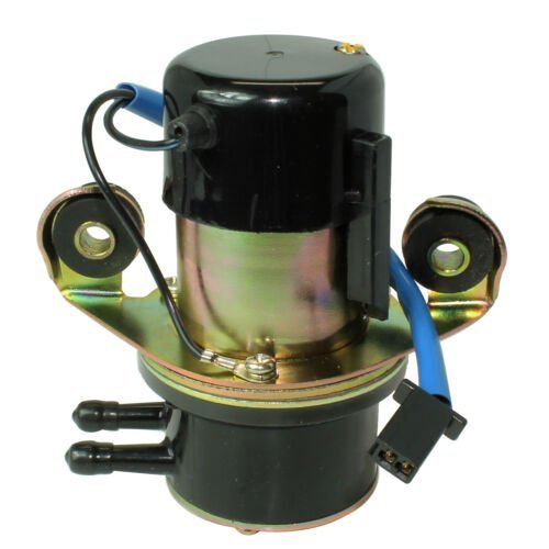

skydoc_17 Posted July 1, 2022 Share #4 Posted July 1, 2022 Hey Pop, On Ebay, Caltric sells a brand new unit for $50 +/- a few. I have installed them a few times with no issues. Here is the link: https://www.ebay.com/itm/291760653742 I have attached a pic! Hope this helps, Earl 1 Link to comment Share on other sites More sharing options...
