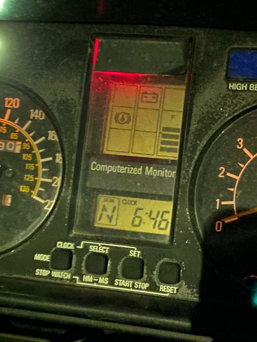

Solace Posted May 6 Author Share #6 Posted May 6 UPDATE! I just went out, battery was 90% full so lets try it. Full choke, she does sputter up to life for a second, I get a good solid put put put put and she's running but then dies out. Runs for 2/3 seconds. Also, why do I have a red blinking light? (Seen here as a solid light) Link to comment Share on other sites More sharing options...

cimmer Posted May 6 Share #8 Posted May 6 If you pull the tape off of the top of the monitor, we can see what the red light is about and help to fix that also if you like. Rick F. Link to comment Share on other sites More sharing options...

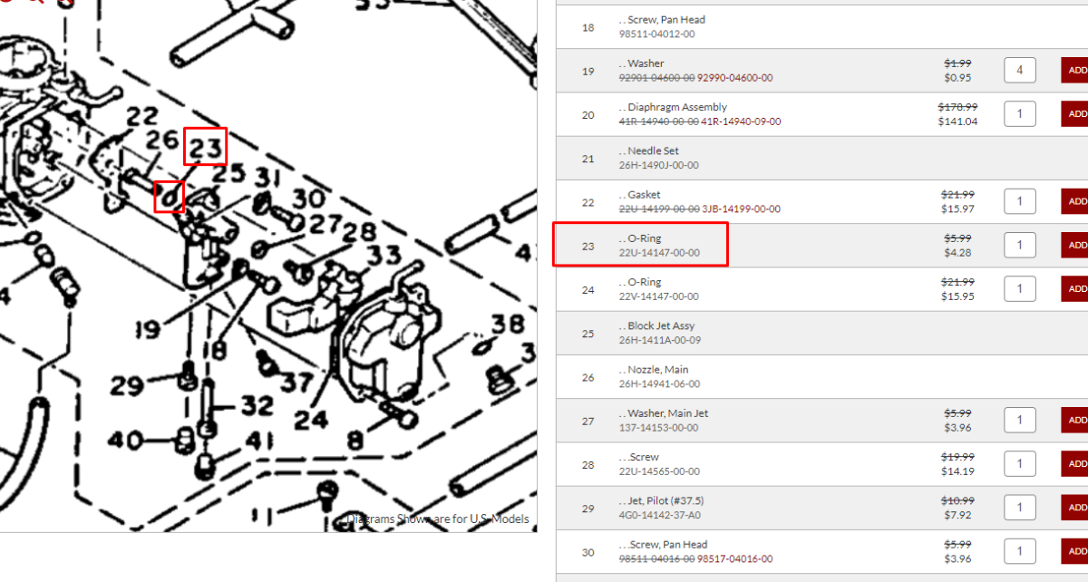

Solace Posted May 6 Author Share #14 Posted May 6 NOTE: I may be missing O-Rings on one or two of the Needle Jet Screws - I noted that they didn't all even install the same way, will re-examine tomorrow. Will that cause issue? Link to comment Share on other sites More sharing options...
Solace Posted May 6 Author Share #15 Posted May 6 (edited) Not sure if this O-Ring is there on possibly 2 of the carburetors, 1 for certain didn't have it. 27 - that's the one Im missing, it's just a washer but maybe screws things up. Going to replace gasket 22 in all 4, each one of them tore slightly. Edited May 6 by Solace Link to comment Share on other sites More sharing options...

luvmy40 Posted May 6 Share #17 Posted May 6 (edited) According to the dash indicators, the red light is telling you your battery water is low and brake fluid is low. I can't remember if that is the front or rear MC sensor. I'd recommend investing some $ in quality parts for the carbs and do a complete rebuild.Mike Eykamp- a.k.a. The Diamond Cut Guy used to sell a rebuilt carb swap at a reasonable price. Still expensive, but considering the parts and labor involved, very reasonable. You also might want to consider an after market CDI from Ignitech. Worth every penny. Edited May 6 by luvmy40 Link to comment Share on other sites More sharing options...
