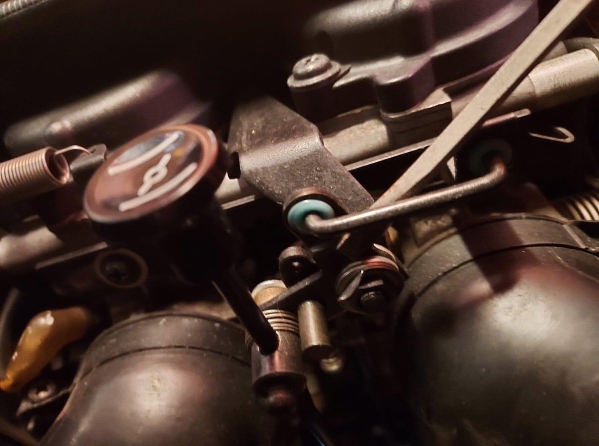

Blackcherry 06 Posted February 25, 2022 Share #9 Posted February 25, 2022 Mine would not stay out when I got it back at the end of summer. One of the guys told me do tighten the nut and it would fix it. There is a washer that the side is folded down that will keep it from turning. I folded that back up and tightened it and then folded it back down and it worked great after that and still does. Here is a picture to help 1 Link to comment Share on other sites More sharing options...
