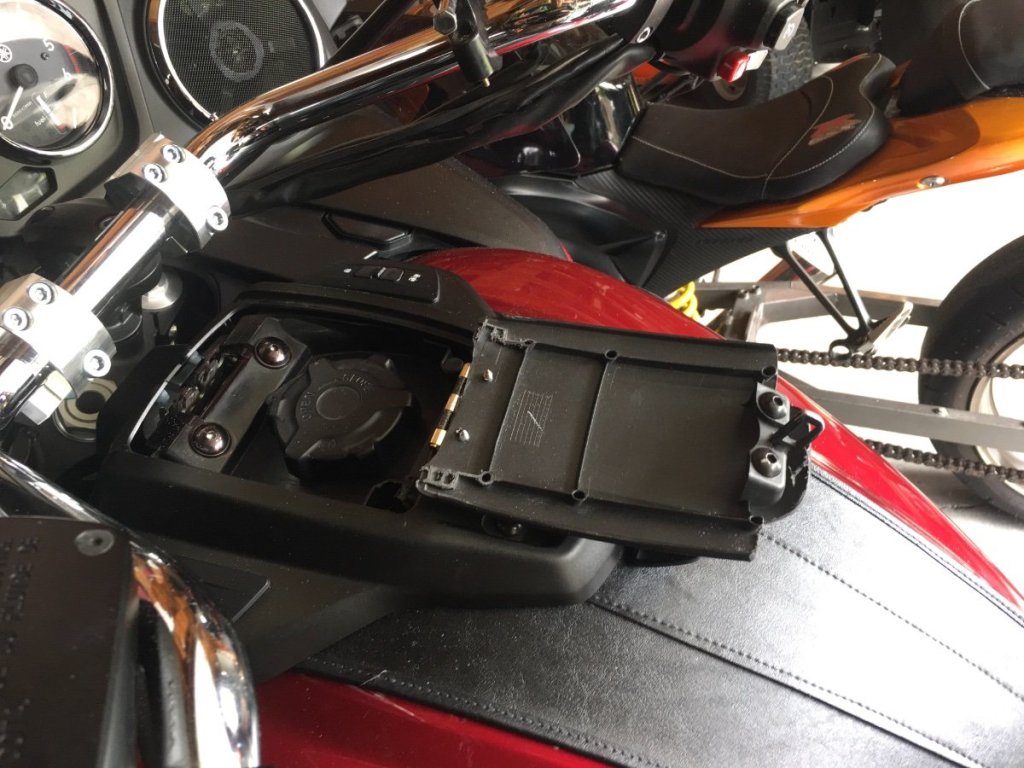

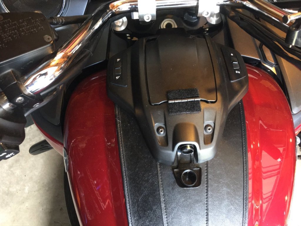

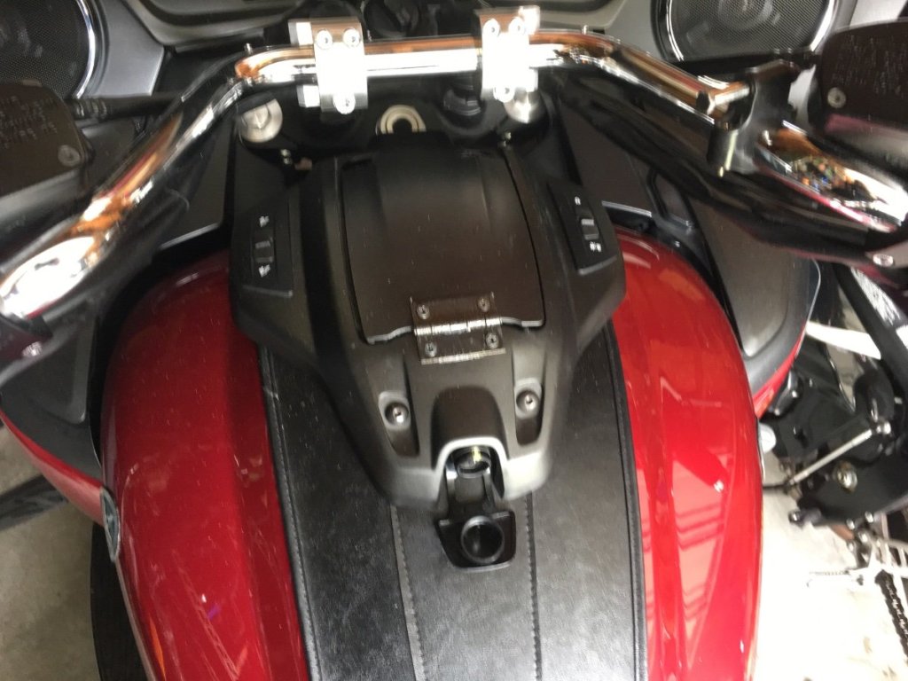

The gas tank lid was designed very poorly and is a hassle to put gas in the tank.I modified the lid on my 2018 Yamaha venture so it would go all the way back instead of standing up at a 90° angle. I bought a 2 inch hinge from Lowe’s and installed it on the back of the lid. I removed the factory plastic hinges with a hacksaw. I covered the hinge with the fuzzy side Velcro to hide it. It works real well. I have included pictures.

It would be tough mounting it on the inside. If you had the right size hinge you may be able to make it work. The outside hinge works extremely well. Just need to pretty it up some
Although it might work it looks as though you’ve destroyed the automatic opening of the lid by the spring.
While mounting it inside may have been more difficult, the resulting “factory look” is always worth the effort. You may even have been able to find a hinge that was spring loaded to maintain that function.

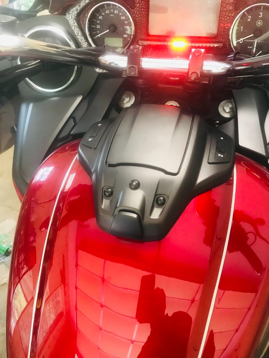

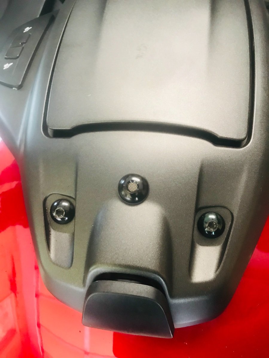

Case in point when I installed the remote microphone for my dual camera system. Installing it wasn’t easy, but the results speak for themself.

There is nothing destroyed on the lid,  it works perfect. I did trim the top of the lid down on a prior project to make way for the Rox risers.
Not sure how you would get a hinge on the inside of the lid but I’m sure it could be done. I don’t think the modification is that noticeable. It doesn’t depreciate a plastic lid that was already ugly, cheap and unfunctionable
