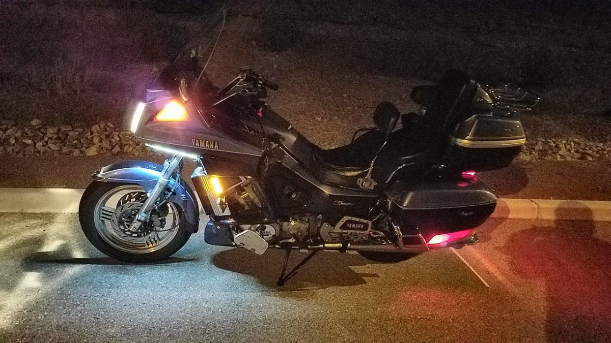

You can buy led panels that replace the side reflectors. Just take off the reflectors and bolt on the lights. The led panels I found fit almost perfectly inside the reflector mount. Just slight trimming. I wired mine to the running lights and turn signals. Get the LEDs that offer two different led sets per light....IE three wires. Ground. Running and turn. This way they also blink with turn signals.
I also added a white led strip under the cowl wired to the running lights.

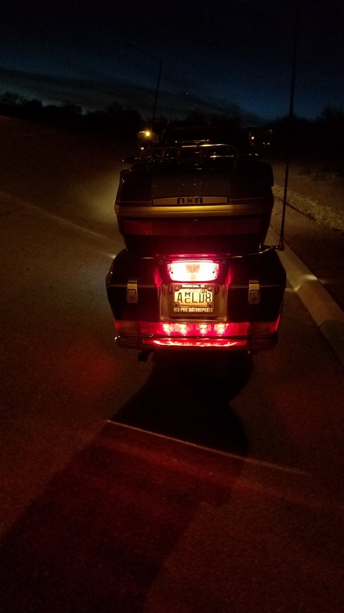

Finally, added a set of lights to the rear reflector in the center and one bulb to the reflector on each side in rear underneath the hard bags.
Pics show result....
The reflector on the trunk is very bright with headlights on it so I left that alone.
